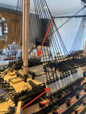

Lower shrouds. The template with the deadeyes attached with thin wire is connected to the deadeyes on the channel. I use this to ensure the deadeyes are in line and run parallel to the channel. The Victory has 22 (11 SB and 11 PS) shrouds on this mast and the Difference in the length of the lanyards between the fore most dead eye and aft most is significant due the the change in angle of the shrouds. The only way I could achieve the deadeyes to be linear is to make the template.
I secure the deadeye with a clove hitches. The whipping of each dead eye to the shroud will be done later. The tie off of the Lanyards cover the clove hitches- this is technically the incorrect way to do it however it will not be seen. Whew....
. This also enables me to rotate the deadeye before whipping to ensure these are correct- I see some need rotation.

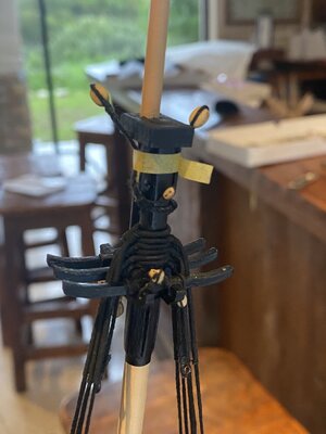

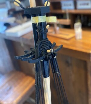

The top of each shroud is served (rope eater for sure). Each shroud needs to be looped around the mast in sequence. Don’t forget the two Burton pendants to go on first- these are not served.
Top mast shrouds. These are connected to the deadeyes on the Crowsnest using a single piece of wire bent to correct gap. These are all close together and the Lanyards are the same length so no template needed. These have been whipped but not tensioned. (Seen in above photo).

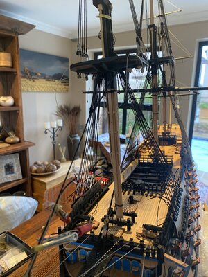

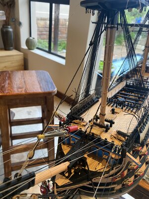

I then do one of the main stays to the bow sprit. I need to do all these simultaneously to ensure when the tension of each deadeye is done the mainstay is also tensioned. Everything will be tensioned at the same time to ensure the mast rake is maintained and the rope tensions are all good.
Now to do 44 whippings on the deadeyes- going to take a while.
