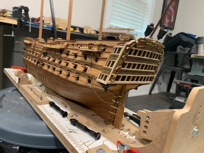

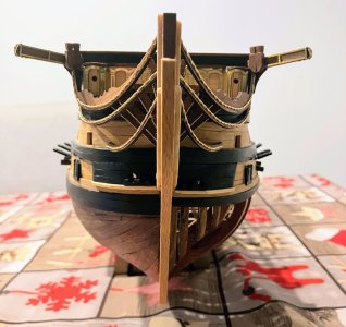

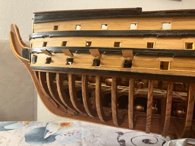

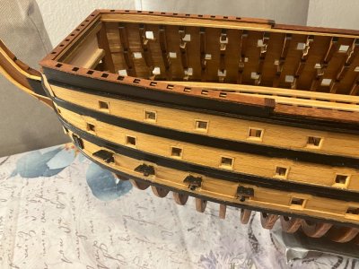

I am doing the same kit. Interesting how you completed the bottom of the hull. I did as well partially to leave the ribs showing. Also like the black. Great work.
Nice ship! I like your style and I’m learning a lot from it. Could you share a photo from the bottom back of the ship? The decorations under the windows seem to fit poorly on my ship.
A couple things I really love that you did.

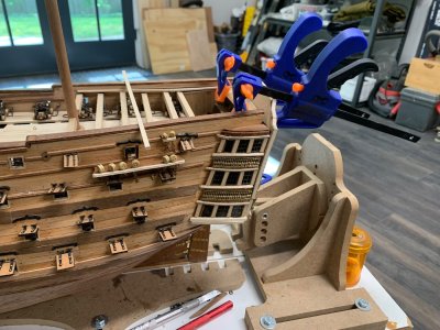

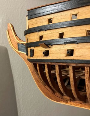

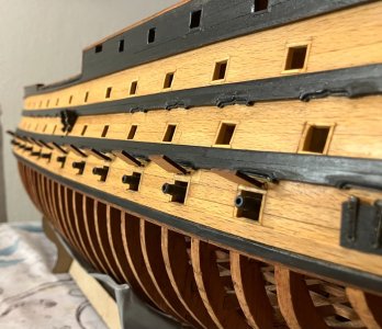

Staining the frame work timbers

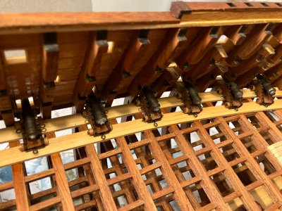

Adding the barrels and the grating to the lower deck.
Cannons look very nice.

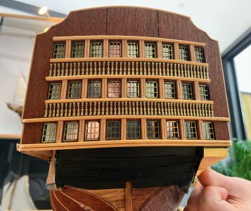

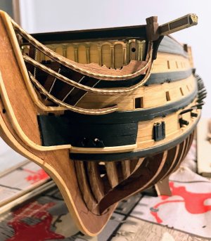

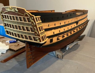

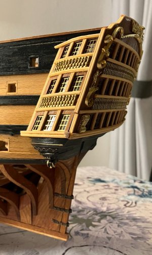

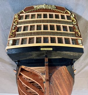

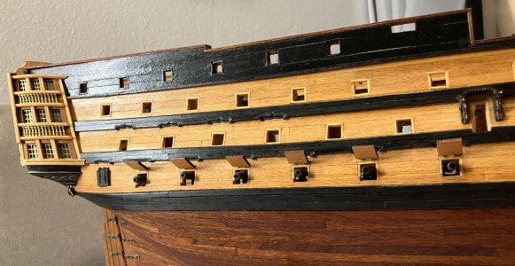

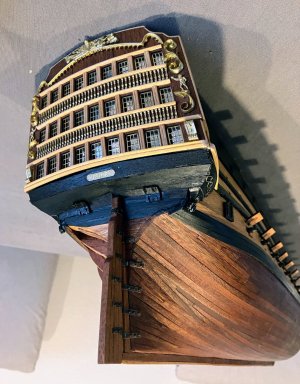

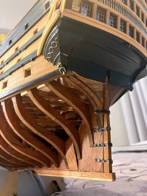

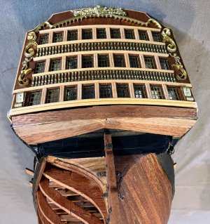

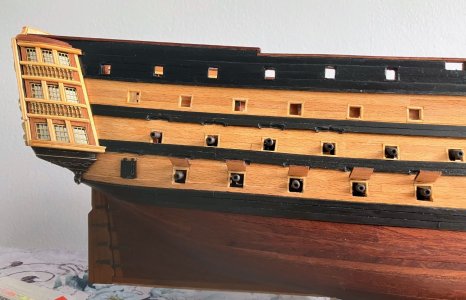

This week, I took some time to finish the back part. I did not like the looks and method of how the brass parts were fitting to the hull. Luckily, I have a lot of spare wood from my previous builds. I used some very thin strips and fill the gaps and painted it black.
I'm happy with the results.
I like the black tackle on the rudder as well. The whole back of the ship looks tight. The rich color to the base plate on the stern under all the trim looks incredible. What stain did you use?
Well done.

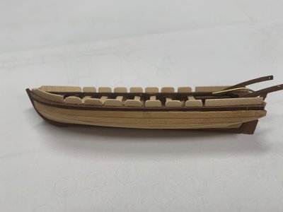

I’ve been doing the little launches which I always dread on any ship.
Hey Krypton,
really beautifully realised. Great work. That's a rear end to fall in love with ...!
Quick question: I think the Victory lettering doesn't look quite right. Are you planning to change that? With the right lettering, the Victory looks even better at the rear. That's not a criticism of your design, it's really mega nice.

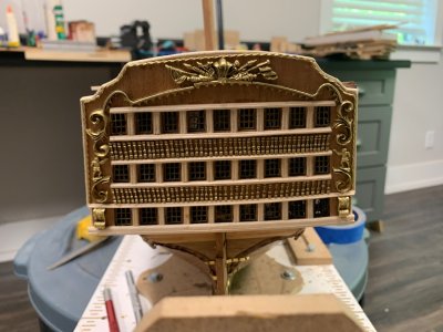

Cheers, Günther! Ship-1
I had a similar thought with my kit about the small Victory plate on the stern but then I figured since this is the 1765 Shipyard style perhaps this was the sign that was originally put on the ship. I think I read somewhere that Nelson had the ship painted to what we now know are the Victory colors but originally it was not black and occre. Not sure if I’m correct on that?

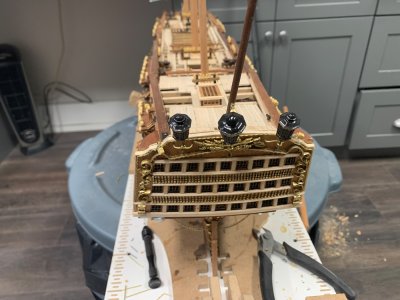

Hi Humble

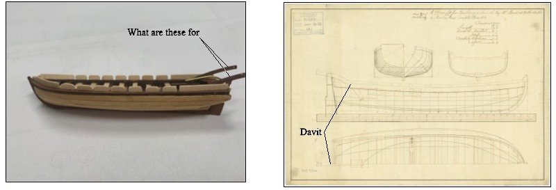

What are the two things in the stern that hang out the back? They look like davits, but the davits on launches and long boats were single pieces with a roller over which the rope ran to the windlass/ winch which is not shown. Sorry for asking but this was a new one for me.
Thanks
To be honest I’m not quite sure either. It was in the instructions and I just went ahead with it. It’s only on the largest launch which is mounted on the deck with the smallest launch is mounted on top of it. The two medium launches are to be mounted on either side of the ship and or 1 could be mounted off the stern .
Therein lies the problem, the kit maker not doing research or ignoring the information. It often pays to do at least a little of our own research on any build, be it scratch or kit.
Is this kit depicting Victory at the time of Trafalgar? The reason I ask, from what I could find, Victory did not receive boat davits on the sides until 1860. I have not been able to find any contemporary models or plans showing davits on the 1765 original build or 1803 redesign and re-build, but hopefully some member has something they can post. There is a POW model of her at RMG showing a set of stern davits, but the date on the model is a range from 1806 to 1829 so not conclusive.
The kit is called 1765 Shipyard style perhaps so I assume that it is supposed to be ship 90% complete on the dry dock.
As I was building the small launches with 3mm planks I was wondering it the real launches would have used 10 inch wide planks for the smaller boats.
I’ll be giving this ship to one of my friends or family and for sure they won’t know the difference.

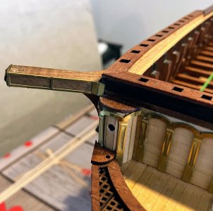

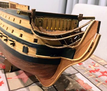

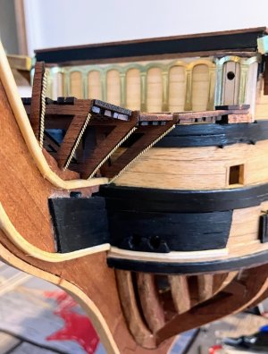

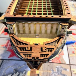

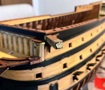

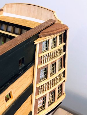

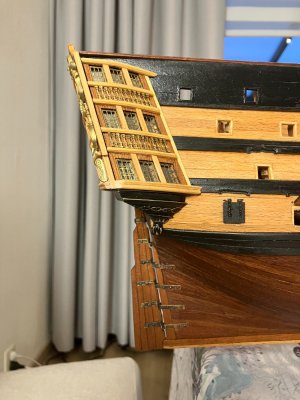

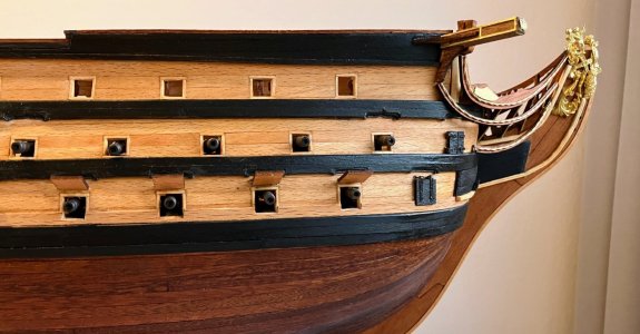

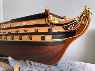

I agree that the name-plate is a bit flimsy. I will think of something better and if I find something before I finish the build, I'll replace it. Anyway, this week I have been working a bit on the front side and started with putting in a new floor. Progress is shown in the photos.
Looks great. The V shaped supports on the bow I found to be very flimsy and easy to break. You did a fantastic job with those and the decoration as well.

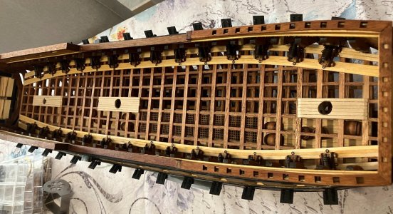

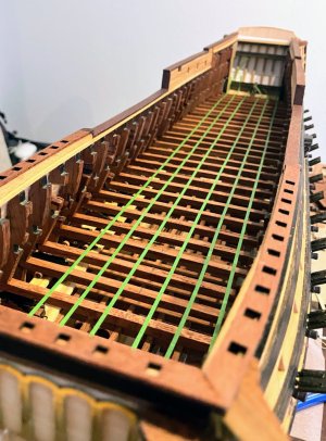

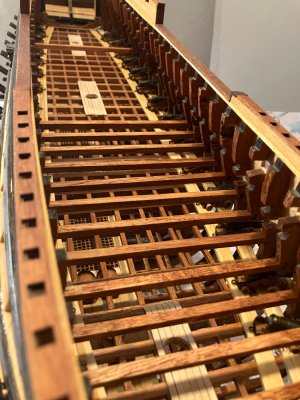

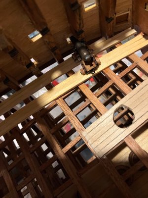

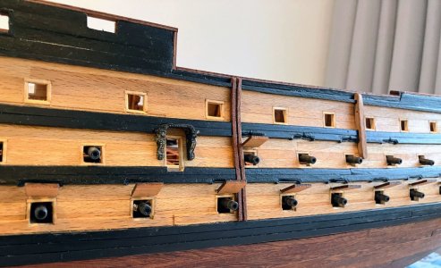

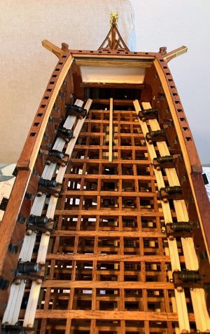

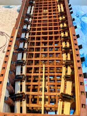

After 2 weeks of work, I finally managed to finish the grid structure of the 3rd floor. I glued in the canons, which did not fit directly due to the wrong height of the hatches. Therefore, some of the canons are missing their front wheels :rolleyes:, which luckily will not be visible once the ship is finished. Next I'll finish the floor and install the next batch of canons hatches.
