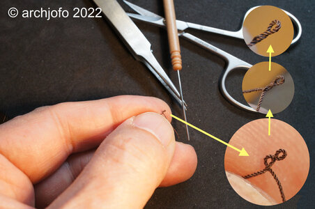

In the meantime, I have started working on the port side ratlines (ø 0.25 mm) of the fore topmast shrouds. These are already about three quarters made, as can be seen in the following pictures.
On the last picture I show again how the simplified splice for binding the ratlines to the outer shrouds is made step by step. For lifting and inserting the end of the rope twice between the strands, I use an appropriately prepared cannula, as already reported and shown.
