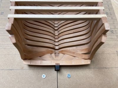

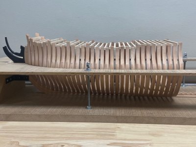

Everything is looking exceptional!!!
Can't wait till you tackle the stern with your meticulous attention to detail, we will all learn something!
Thanks for sharing the wonderful photos.
I have always been in love with this frigate for that reason - incredible lines as do most of the French vessels as you are well aware ! If I finish this one, the next one will be LEgyptienne for sure - although its almost more of a 74 in a lot of respects than a frigate.
Beautiful work Chris! I can't get over how much tumblehome this ship has.
Looking good
