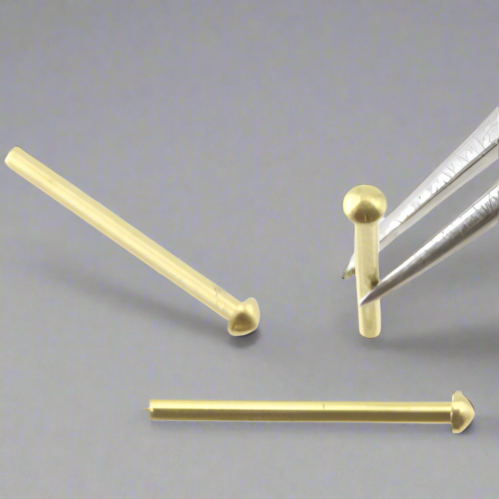

Are those the copper 0.7 mm nails Uwe? I’m planning to use 0.7 copper wire but still somewhat unsure about the best diameter to use.
The copper nails have diameter 0,6mm
Maybe you remember, that I tried on my first rows on the hull the preparation of the heads with the burrs - for these two rows I used 0,7mm nails
afterwards I changed to the 0,6mm nails - so you can see now the difference directly on my model
the red area are these two rows with 0,7 - the green area are 0,6mm
and here a very close look, where you can realize the difference (on the left of the red line 0,7mm - on the right 0,6mm)
Thank you Uwe. I’m not planning to mess about with burring the head. I have looked at using domed nails in stead of the flush nail/wire, but they seem out of proportion. Copper 0.6 wire it will be (can’t seem to get the nails here in the uk and wire is a lot cheaper
Yes - wire is cheaper, but nails have in my opinion a big advantage.
I am pre-drilling the holes with 0,5mm and with the point of the nail and with some slight hits with the hammer it is much easier to push the nail into the hole
BTW: the copper nails bag I am using has 50g nails, which are appr. 1.850 pcs - so with one bag for 13 Euro you can nail the complete hull of the Le Coureur, with reduced time for the preparation -> these are the reasons I am using the nails
I looked at the site you sourced them from but I can’t find a similar site in the uk.
Unfortunately Modellbauplanet has no copper nails in stock any more, but they can organize them.
They deliver international (Germany - Austria was also international)
Or you try to contact directly aeronaut - they will also deliver to UK - I am pretty sure
The problem could be in moment, that most of the nails are produced in Italy, and there seems to be some problems in production
On the other hand aeronaut has a search for aeronaut dealers - there are several shown in the UK
Hallo Uwe, Hallo Chello, The reasoning to use nails is quite correct from Uwe's point of view, but Chello you will manage just as well with the wire.
I used 0.6mm copper wire for my gaff sloop, predrilled 0.5mm, cut pieces of wire to size, held them in place with tweezers and hammered them in with a small hammer. Worked quite well.
Check these guys out in USA, they bought the old ScaleHardware business and restarted it.
They are an alternative, nevertheless a very expensive one.
with 7 US$ per 50 pcs it would cost around 250 US$ to nail the hull......
