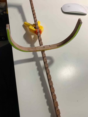

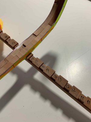

Testing frame #16..
It fits perfectly but the middle line on a template does not align with a keel, not to worry, this is additional template (for sanding) I put on but will replace it with correct one. This one does not fit the frame parts, moved to the right 2mm approximately...

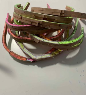

Pile of frames keeps pilling up...
Some parts needed to be redone; some are gone missing somewhere, or stolen by my cat, or will just be located when I start cleaning up my hobby room; anyhow, usage of old parts is there..
Shhh, don't tell anyone, some of frames will be "simulating" edges, like we do for deck planking, simulating planks, out of one long plank... I would call it "using different techniques for frame build"... Did not follow the gran in purpose for those one, just want to see how this works.. if does not work, will re-do correctly..

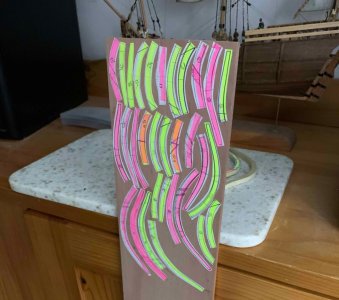

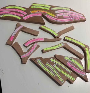

OK, parts are cut from the board and ready for raw sanding..
Sanding is done, now correct thickness was achieved buy running each piece thru mini table saw..
There is always a lots of leftovers, that can be reused somewhere on scratch build project..
