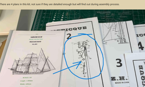

There are 4 plans in this kit, not sure if they are detailed enough but will find out during assembly process.

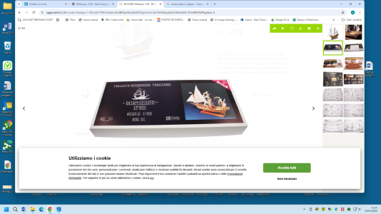

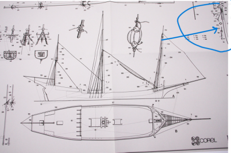

Dear friend, you are unaware, then you have no guilt, but this guy is a pirate copy from ZHL, although in a different scale, of Corel's Mystique SM 21.

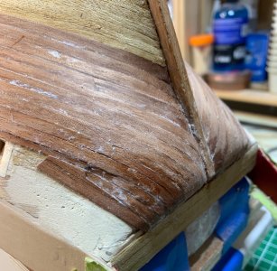

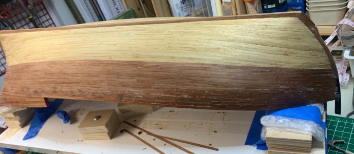

My planking exercise keeps me busy... and very curvy hull is giving me some challenging times... it appears that this darker wood is very generous when it comes to twisting, just need a bit or either water, alcohol or anything water based to have it very flexible. Have not tried a wine yet... For those weird angles I am using CA mostly and white glue to cover holes. I lost lots of skin so my fingerprints will not be acceptable on any border for some time :).

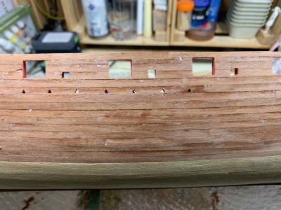

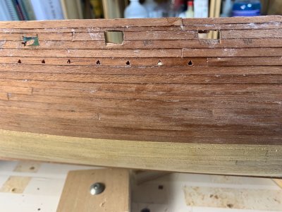

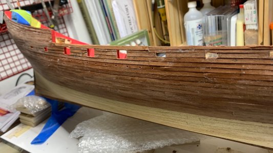

Planks were covering water openings so needed to drill a small hole from the inside just to point place for triangular file... also area where I planing to use a file to widen the openings, covered with CA to keep the plank strong and not prune to splitting and cracking but still careful usage of file is required..

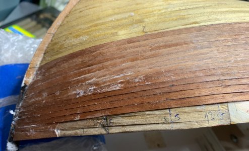

I think planking this challenging curved model, I broke every single rule in planking steps :)
Getting to the last few planks and preparing the hull for nice amount of scrapping and sanding before layer of paint will be applied..

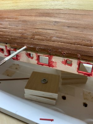

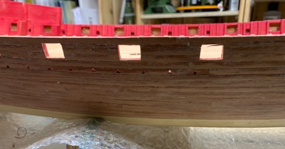

On the inside side of planking, I run lines of CA glue to the gun openings to harden planks so they will be hard to break during opening process. In the past I had some issues with split or broken planks when holes are drilled and sanded around gun opening and hopefully this step will prevent it.

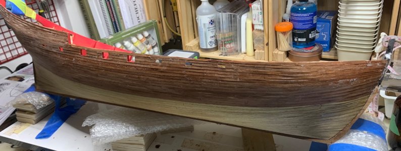

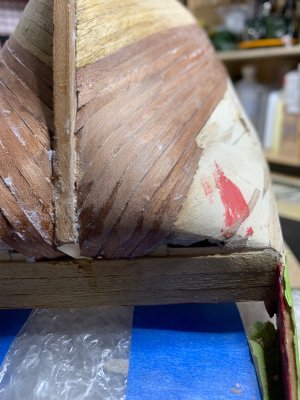

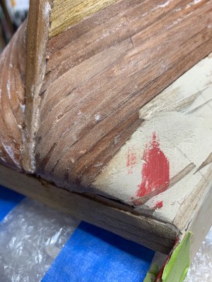

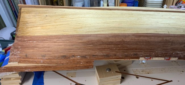

The planking has been completed; now the work continues with scrapping, sanding, potentially filling some holes, marking the paint lines and waterline and painting. On this one I will try doing airbrush the first time on wooden ship if I can locate some safe space protected from paint and well ventilated to leave ship/paint to dry. That will be interesting...

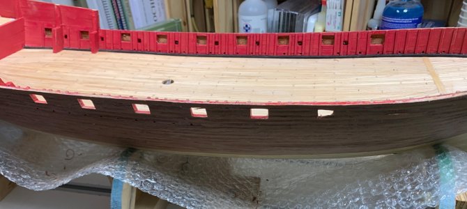

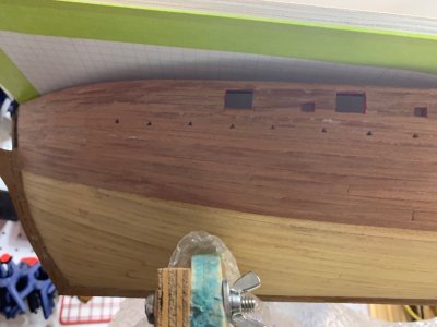

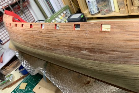

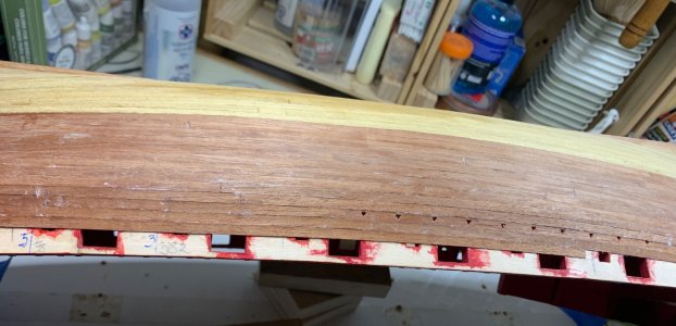

Some sanding was done; now I am working on opening gun and oar ports. Dropping a line of CA glue around port openings and veneer on the outside, helped keeping veneer from breaking and splitting.
Also, I working on filling those water openings to keep them nice and tidy..

Once I complete with port work, I will run one more layer of red colour on the bulwark, to cover some dark spots and tiny marks caused by work on ports..
Happy modelling.

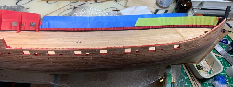

Touch up of a red colour is completed and protective blue tape removed.
Today I continue with assembly, attaching the "board", not sure the name but it is located 2mm under the lower port opening side. The board was painted in black first then glued with CA and left drying secured with clamps. The challenging part is towards the bow, where curving is manageable but need some soaking and bending.
First I measured 2mm distance and run a layer of panter' tape as a reference point.. Then just glueing and securing..

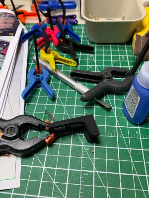

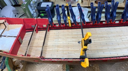

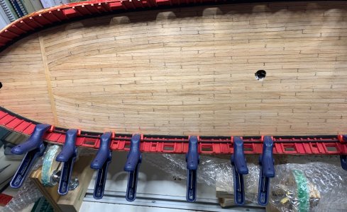

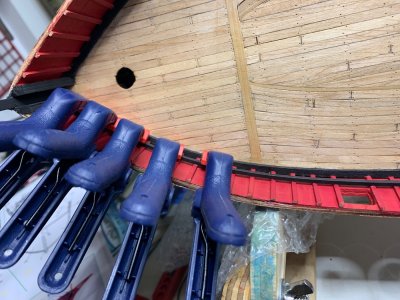

My work on the bulwark continue, adding more boards and secure them with clamps, nothing exciting here...

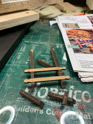

Just to break routine a bit, I started assembling some other parts.
Cut them from the frame, light sand to remove some laser burns... then put them on the deck to visualize the setup..

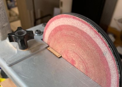

There are needs to sand a bit these longer parts in order to accommodate curvature of the deck..

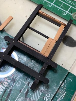

Then after all is sanded and tested, I put them together since it will be easier to paint assembled unit (I mean assembled as much as possible) instead of one piece at a time. I also want to add some simulating spikes by using 0.7mm coper wire...

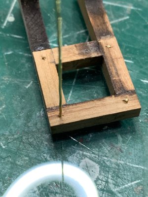

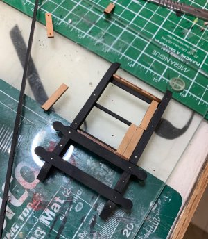

I worked on two assembly units; first I assembled parts..
.. tested fitting..

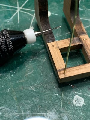

.. then drilled the hole using hand drill and 0.7mm bit and pushed in wire. Left some extra wire sticking out since it will be sanded once unit is painted in black.
At the end, the whole unit is painted in black..

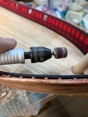

Today I widened the opening for masts, using proxxon extension and drum...scary tool for a ship model .. but managed not to damage the surface.

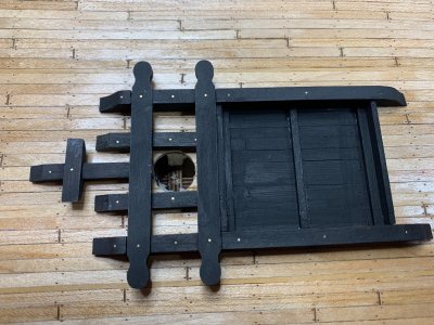

Removing the laser marks..

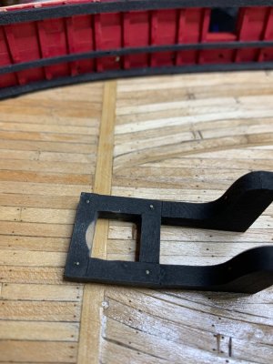

The kit manual does not provide any measurements and all had to be done manually, testing fitting before glue is applied.

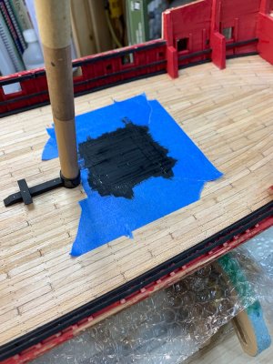

Then I marked down the area where black paint will be applied, simulating entry to lower deck..
And painting done..

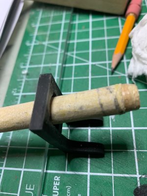

Here you can see my mast wide simulation, black electrical tape around 10mm rod to get 14mm total; this model is big and i cannot fit the mast and ship on the working area on the desk. I will need to get some lower possitioned desk for work on masts, rigging, etc...

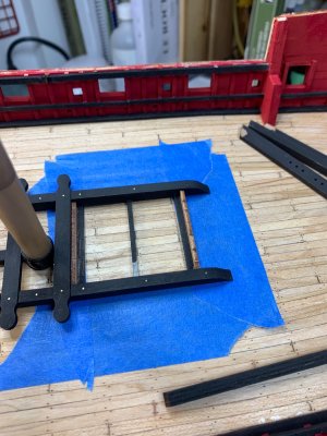

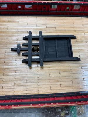

I have mounted mast framing to the deck...

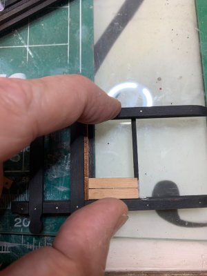

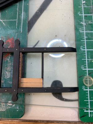

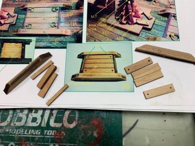

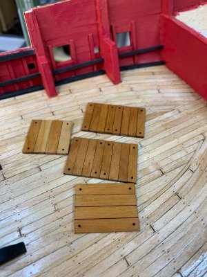

I also prepared all hatch covers; at the back I combined them into one piece by running a blue painter' tape and glue boards to it. I will not have functioned hatch since there is nothing to peak down to... so the hatch covers will be fixed. I run a layer of tung oil on them to bring up the wood colour... and it works just fine with black head ledges.

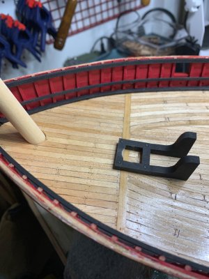

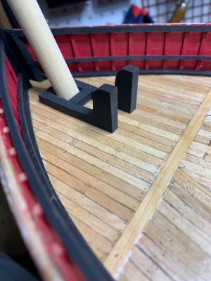

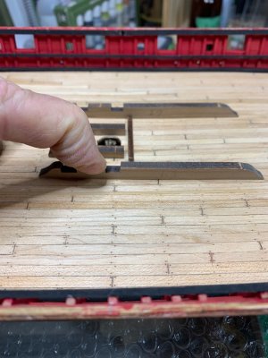

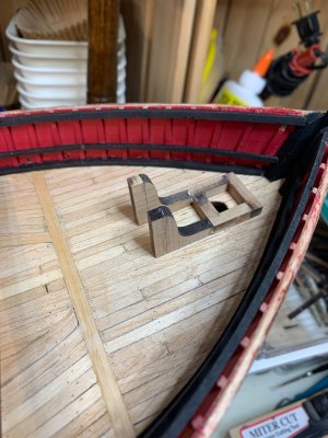

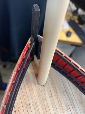

Now, I also worked on foremast framing... the one has to be under certain angle, so after I opened the hole in the deck, dropped in a foremast and tested framing fitting. Framing have to be slightly sanded under certain angle and for that I just use a piece of wood and cover it with 400 grid sanding paper, then sanded frames until I got correct angle.
Then testing was done to make sure fitting is correct.
Once I am fine with position, I covered the sanded part with black paint again..

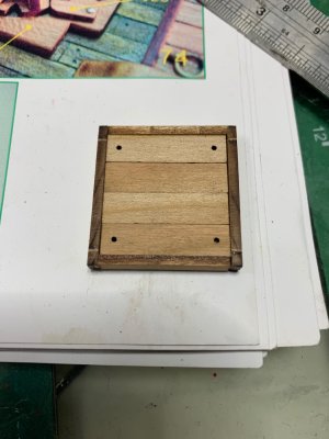

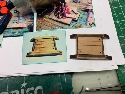

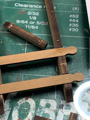

I also worked on other hatches, assembling them after light sanding to remove the laser burn. Not much attention for a laser burn because they will be covered in black...

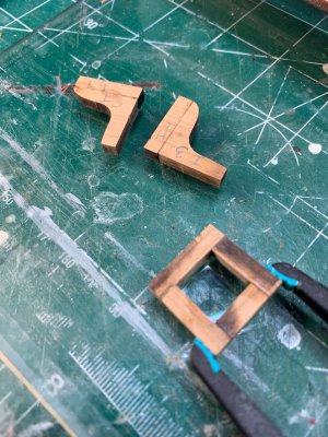

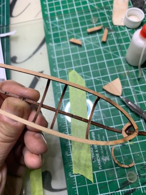

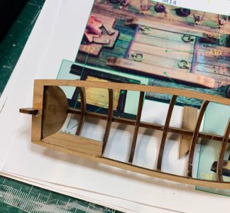

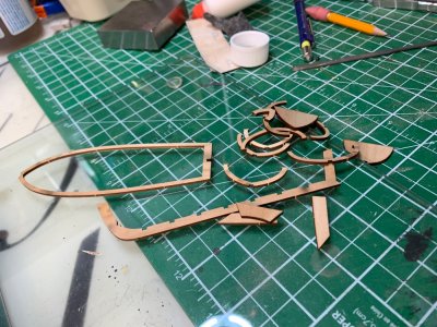

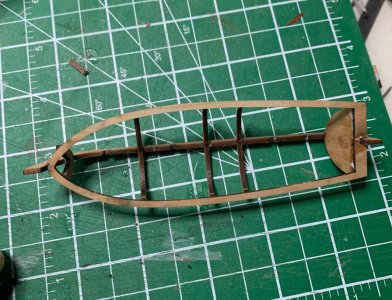

Next I worked on ship boat.. for this one I made a mistake not marking the parts (frames) so had a bit of exercise putting them in correct order...
Stern bench needed to be redone, because fragility of material showed me how tiny they are message.... guessing need to make a new one..

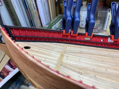

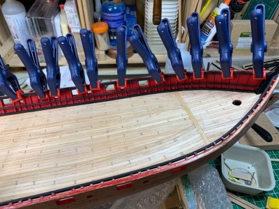

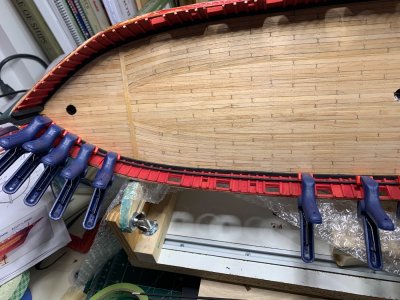

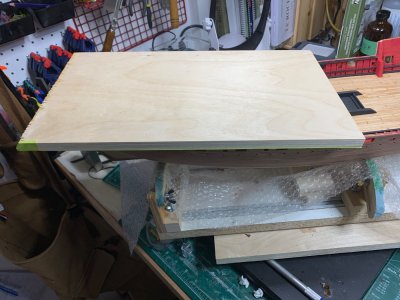

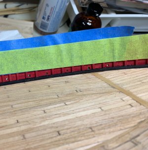

While I am thinking of what planks to use for a boat structure, I started to work on board for deck railing. I the past I added extra layer of planking to make the bulwark stronger which ending up in the fact that kit provided boards are not wide enough. Which is OK since I tried to laterally bend kit board with absolutely no success, beside the fact that breakage might be success in some forms, but not in this case.. so the new board has to be made..

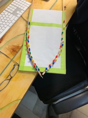

First I need to get the curvature of the deck, since kit plan is not in 1:1 scale and for this is pretty useless.. Template board was made...
.. dropped on the bulwark,
... peak from the bottom...
... deck was marked down and new railing board was attached to dry, after spending several hours deep in alcohol..
