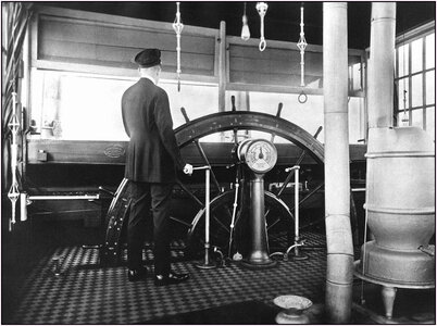

The web site www.Steamboats.com also has an archive with many photos, which also includes a series on Pilot Houses. There I found this beautiful image of a layout. And shows how big the steering wheels were.
SOURCE: https://steamboats.com/museum/davet-pilothouses2.html
