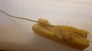

I turned my attention to the Anchor Cables. Using the beewax really helps in the fraying and fuzzies. I used a small piece of 2 x 4 x 8 mm with a drilled hole so that I could insert into hawse holes of which keeps the cables from coming out and not having to worry about trying to get glue in there.

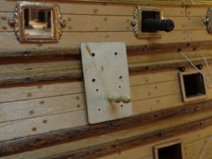

Ok, now I am drilling out the openings for the Lid Hinges on Hull and also the ropes that raise the port lids. The first JIG is one that I made so that I will be drilling INTO the false Cannon supports at the correct angle. A few tries were done to get the angle I wanted. I used the Mill and Angle adjustment plate to achieve this. All I can say that it is a blessing to have a Mill and a Lathe.
The other JIg came with the box as it helps make proper alignment of the holes for the Lid Ropes and the Hinge.

Hallo Donnie,
do I see it correct, that you are drilling the holes with a hand driven drill?
I think with an electric drill like Proxxon or Dremel, the jig out of wood will not work for several gunports,
due to the fact, that the drill would also widen the jig with using it several times .....
Very good idea, especially also for the jig for drilling the holes for the gunportlids - very accurate and clean work 8-)

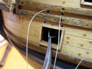

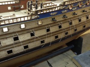

I really appreciate all the kind words and encouragement. I think I am creating more work for myself on this ship. However, I thought I would take a few pictures of how I am managing the Lid Ropes. (I am sure there is name for them). The last two images is a sneak peek of my Cannon Port Lids. I will show in detail at some point how I did those. That is a brass rod that I have the rope tied to so it will not pull through the hole.
G'day Donnie
Brilliant work. You extra work has been paid off and the result is model that you should be proud of.
I call the ropes 'cannon port lid's rope'... I don't know the correct name also!
So I'm in good company.
The blacken brass hinges are also brilliant.
Happymodeling
Greg
I want to agree with Greg, the hinges are looking very good. The way of installation of the lid ropes is very good, thanks for the series of close up photos, which are documenting your way in a very clear way. Many thanks for this
They are called „spans“ of the gun port tackle.....I think

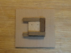

I really appreciate the positive feedback. You all are much too kind considering the other builds I have been watching with beautiful carvings. Well, doing some task over and over can be stressing, so I took the time to create a jig for both the hinges and the port lid alignments. I decided to drill an "extra" hole for the hinge as it looks a little more realistic and will also keep things in place when glued in.
The cannon port lid jig was made to keep the "centering alignment" correct with all lids.
Steps are shown below:
Hallo donnie,
Very good ideas with your jig showing us, especially I like your „push out“ 8-)
