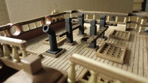

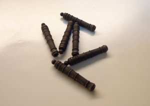

On with some more Bitts in the fore and starting to work on the Blackening of the Cannons. I finally found some agent (I think someone else here is using the same thing as I got the idea).. The stuff is the best I have ever used. Just 5 to 10 seconds is all it takes. I like the old rough look that it gives.

It is looking realy good and many thanks for the hint of the blackening finish.....
One small hint: for me the outlet of the chimney is not looking in scale due the the fact, that it is wood with a certail material thickness.
Originally they were made out of a metal, so I would try to reduce the thickness of the chimney walls with carefully drilling or something else.....
Excellent work Donnie. From my card modeling days, I used to roll cylinders and gun barrels around a piece of dowel with heavy thick coloured paper and then coat with PVA glue. This dries hard as wood and looks far more authentic than even if made of metal. The chimney will turn out strong and realistic made this way.
That's a whole lot of work Donnie. I'll bet you'll be glad when it's finally finished. Looking great though so every minute in the journey makes it all worthwhile.

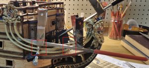

Thanks guys. It is received with a great deal of humility. On with more details of the head this time. I removed the medalions from the railings so that I could work on the (gold) rails better. As you can see then I took the whole assembly and placed it temporarily until I figured out how to manage it. The brass "pieces" that support the gold railings as well as the other was a trick and a lot of strange clamps and files to help hold the gold railings just at the right position.
I highlighted in red rectangles the parts that were of interest trying to get them to line up and the reason for all the clamps, files helping with the alignment. Well, you have to do what you have to do sometimes. It might look like a disaster, but so far it is working and nothing has "sprung" loose.

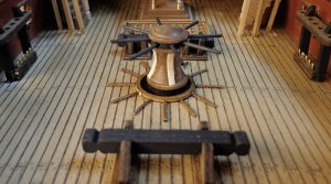

Well, guys - you are much too nice. I am so ready to get this kit off my workbench, but I keep adding things to it. For instance the Capstan came as a boring dull piece, so, I liven it up some.
First Image are the pieces. The handles to turn the Capstan are made from Brass rod and blackened. I had to drill the holes in the Capstan for the handles. I also added a little black "boosters" or pads underneath. The only reason I did that was to add a sense of "depth" to the capstan as if it were attached to a main shaft underneath. It did not seem right for the capstan to sit right onto the deck. So, I tried to make things a little more realistic.
I would like to wrap a few turns of rope around the capstan as if it were already attached to the anchors. I would assume that the rope would travel through the gratings down below? I know that there is a messenger cable. I think the cable that goes around the capstan is a "closed loop" and the messenger cables temporarily tie onto the main anchor cable and as the capstan turns, the crew is down below shifting and tying and untying the messenger cable off of the Capstan cable. Or at least I think this is what I understand. In other words, the capstan will always have about 3 turns of rope on it no matter what as it is a closed loop. it is the messenger cable being attached to the anchor rope that helps hoist the anchor.
