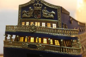

Nothing really major to report except the fact that I finally got all those rails on. What an ordeal. Got my lights tucked into place and will make a cover to hide the square opening.
Thank you Gary and others. I wish that I had more time to visit everyones elses build logs... maybe that will come later. I am FINALLY over the hump of getting all this Stern Lighting done. The switch is mounted and all the wiring and 9 Vdc Battery is hidden inside the Gallery. There will be more brass decorations that will go around the mid (blue) stern from side all the way around to distract from the cutout that I made (trap door) for battery.
