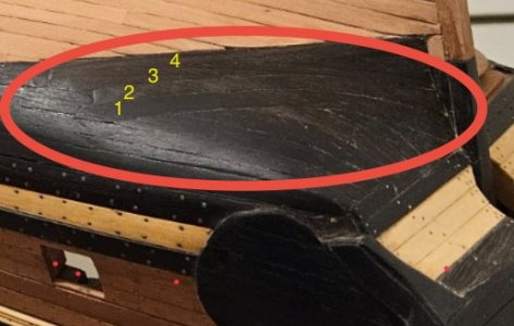

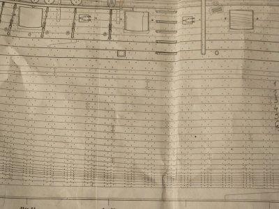

the planking in the area that you marked in red in the picture, (made of ebony wood) is based on the plan in the monograph as well as the most impressive and beautiful work of our friend Richi (Giampy65).
I am attaching pictures from his diary

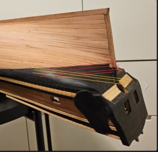

I look closely at the picture, I notice that your planks (red) aren't actually following the same direction as (yellow). So my question is, what happened? I'm asking because I'll get to that point at some point.
As far as I can see, you have laid 4 rows differently here.
Thanks Shota for your answer.My dear friend Tobias
First, I would like to commend you for your keen eye. The explanation for how the boards were installed is that unfortunately it was a compromise due to the design constraints of the boards and the hard properties of the ebony wood.

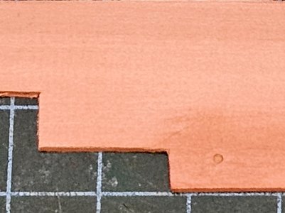

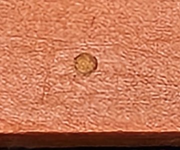

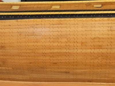

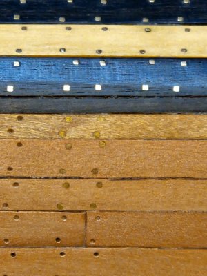

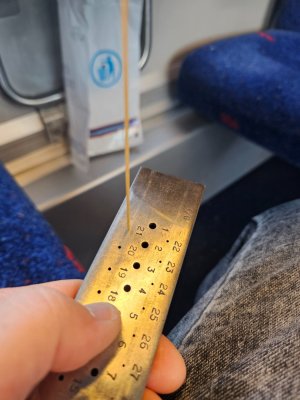

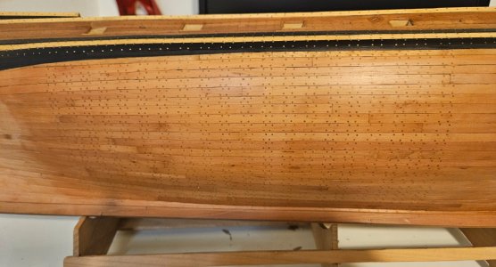

in the last three weeks I have been focused on preparing and installing the wooden nails that connect the planking boards to the hull of the ship.
I make the nail picks from boxwood that I bought a few years ago from bibigon in Russia.
These are square pieces measuring 1 mm × 1 mm. I round them and reduce their diameter to 0.7 mm.
The work is sometimes done even while traveling by train .

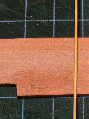

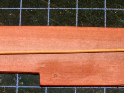

I would like to point out that prior to installation, experiments were performed on a pear board to ensure that it was to my satisfaction.
Since the model has 54 frames and the boards that make up the planking consist of 23 rows of boards, I am supposed to make and install about 5000 wooden nails.
So far, about 1800 nails have been installed on 20 frames. This is the interim result after several sandings and applying a layer of linseed oil.
