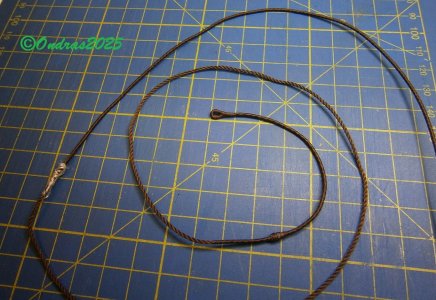

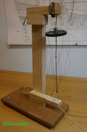

Thank you Stephan.Nice ropes Ondras, you aware of heating up Gütermann or polyester rope to keep te rope in shape after you made it?
And ofcourse Happy birthday.
Better use polyester yarn to make rope. You can colour that with Judea bitume like Mat did on his Papegojan. A real good looking result.Thank you Stephan.

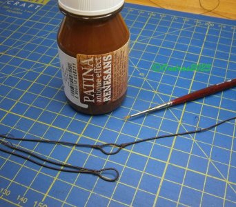

I only use cotton threads, it certainly doesn't make sense to heat them.
I tried to patina the ropes, but the cotton absorbs the paint and the result is bad.
Another disadvantage of cotton threads is that they cannot be used to weave very weak ropes..

Hello Stephan. I have studied both of these fibers, Mati's ropes are the best for Papegojan. I have bitumen at home, but it doesn't work on cotton ropes, the ropes soak up like a sponge.Better use polyester yarn to make rope. You can colour that with Judea bitume like Mat did on his Papegojan. A real good looking result.
The only thing with polyester rope is that it will unravel when you cut it, but that's why you bake it short in a oven.

Glad you think about synthetic ropes. For example, with Gütermann Skala 360 you can make very small diameter ropes, like 0,2 mm. With cotton almost impossible. And your right about that cotton reacts to humidity. Synthetic too, but it's so minor you can't see the effect. Another advantage is that it last much longer on your ship. Cotton will break apart in time. I use Gütermann Skala, Mara and Amann Serafil.Hello Stephan. I have studied both of these fibers, Mati's ropes are the best for Papegojan. I have bitumen at home, but it doesn't work on cotton ropes, the ropes soak up like a sponge.
I'm thinking about synthetic ropes, especially after I saw situations at competitions how cotton ropes react to air humidity. In a dry place they loosen and sag, in a humid place, especially in Burgas by the sea, they stretch like a string until they bend a log.. I couldn't believe it..![]()

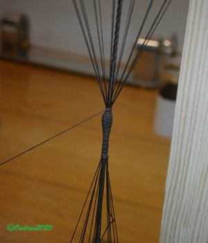

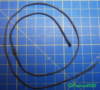

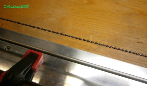

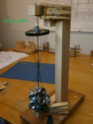

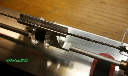

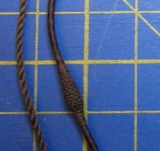

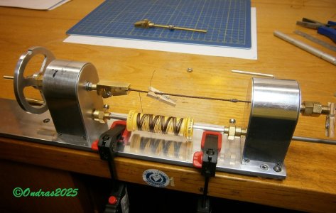

WitajZnam maszynę do owijania lin. Muszę potwierdzić, że autor Roman z Polski opanował ją z wielkim kunsztem. Super koła zębate z delikatnym oporem zapobiegają rozplątywaniu. Polerowany materiał mosiądz i aluminium. Wymienne części do wielu różnych czynności. Bardzo przyjemna praca.Kciuk w górę

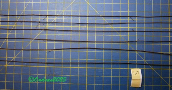

Słabsze liny owijam bezpośrednio, mocniejsze zaś wypełniam nicią.

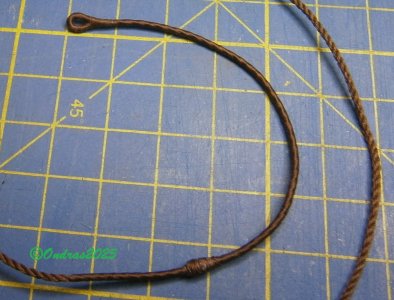

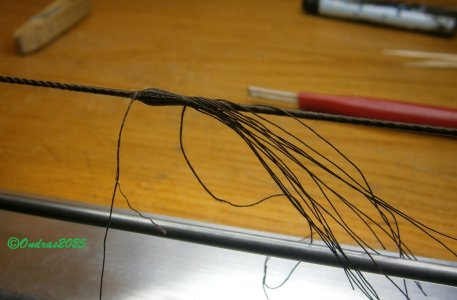

Stałe liny olinowania plecione...

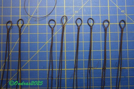

Inne prace: osłony kantarów, oczy i podstawowe akcesoria Stay Mouse.

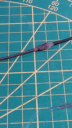

Brud z superglue dobrze patynuje się z brązowym bitumem.
Teraz zaplatam Stays Mouse. Znalazłem tę pracę 1:1 na replice Duyfken..Eksplozja
