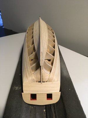

Looking for some planking advice please.
I am just about finished my first of three planking belts. Call it Belt 1 of the three belts. The kit planks are 1/8” wide, at 1:64, equating to 8” upscaled.
I tried to adjust the gap at the stern, where the last two planks (of Belt 1) are to be fitted, by firstly laying the last plank (call it plank 8) so that it lines up with my 1/3rd mark on the counter. I glued it into position leaving me space for plank 7, as can be seen in the photo. I did this because I am trying to line up the planks on my measured marks along the entire hull.
Plank 7, when fitted, will narrow then as expected widen at the stern. Scaled up at 1:64 it means the plank measures about 6” in real width to, yikes, about 14” width aft. I have a number of options but I’m hoping for some advice please.
  1. On this size of vessel is it realistic to have a 14” tapered plank, going from about 6” to 14” aft? The plank would be an actual ship size length of 24 feet. If so, it fills the gap nicely, problem solved.
  2. If not, do I run plank 7 at 6” width all the way aft. Then use a stealer, which I am trying to avoid.
  3. Do I remove plank 8 with possible damage to the counter and lay plank 7 first? I am trying hard to avoid ungluing that. I think that means a stealer too.
  4. This single plank hull will be covered in copper plates. I realize I can just “plank the gap” any which way but I am trying to learn from this.
  5. Option 5 is a beer :)
Thanks for any advice, input and help.

If this was a double plank job I’d just move on. I think my calculations went awry, I’ll see when the advice hopefully flows in :)
I'd go with option 5! :) Just kidding. Plank 8 follows natural bend, but it does not look right. Up to and including plank 6, looks great. I'd either bend plank 7 and subsequent ones sideways or cut them to shape from sheet of wood. Very nice job so far.
Hello Gennaro, thanks for replying. I just started Option 5 after mowing the lawn :D
I agree plank 8 looks odd. It suddenly diverges and doesn’t “feel” right. It might be the camera angle so this fuzzy shot below may be a better angle. Your idea cutting from a sheet is worth thinking about. It follows my thoughts too. I was going to try with a 7/32” plank, reducing to scaled 6” back up to 14”, but wasn’t sure about how realistic that was in ship construction.

Roger let me show you how the problem should be tackled. These pictures are from a Dutch modeler @pietsan Piet Sanders's build of the Swedish Yacht Amphion. The advice I am about to give you may not be the easiest but if you are serious about planking correctly ....
First off, you can see that the Amphion has very much the same curve at the stern as the Syren. Thus ... we are comparing apples to apples.
Secondly, just as you would narrow planks at the bow to create a continuous flow, it is sometimes necessary to do it at the stern as well. The red lines indicate from where Piet has started to narrow the planks.
Thirdly, after the first 6 planks or so, you also need to start planking from the keel as that also has a major influence on the "line" that you visually see the planks follow. That is why I don't like the "band" or "zone" method - it does not allow for the individual character of each hull.
Now REMOVE PLANK 8 and place it directly adjacent and butting firmly against Plank #7. After the hull has been closed up, this will be what you will theoretically be left with.
Then you can pinpoint the exact size and shape of the stealers that you need and insert them.
And when all is said and done this is what it should look like. This picture shows the second layer of planking being applied (not applicable in your case, I know) but it does show you the overall effect.
I hope this helps.
Hello Heinrich,
Thank you so much for your response and excellent advice. What you say makes a great deal of sense and will certainly ease the roadblock I am facing.
I spent quite some time attempting to follow the “band” method, which had me more confounded as the days went by. Your photos and clear “instructions” provide me with a way forward. Sometimes we don’t see the forest for the trees.
The good news is I only have one plank to remove as well as those now annoying cotton belts.
Thank you for your time and help, it is very much appreciated. I am eager to restart in the morning.
Best wishes,
Roger
