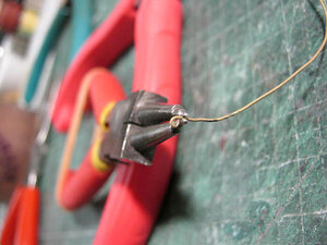

Anneal a 0.5mm brass wire to make it easier to process.
I am processing the tip of pliers made by 100 yen shop. Jig for S-shaped hook production.
The tip is processed in this way.
It's just a shaving, but it's a special jig.
FD-043 of FLING DUTCH MAN production note
You appear in (laughs)!
Do the same thing to make an S-shaped hook!
Anodized 0.5mm brass wire...
Turn it around...
Change the pinch position...
If you turn it around...
It looks like this...
If you cut it with a snap, the S-shaped hook will be finished.
I was able to do this. But that's all for today. Ah! !

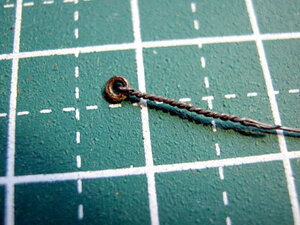

After making the S-shaped hook, I also made eyebolts and rings, and dyed the eyebolts black with gun black.
The ring is for train vehicles. I only need twelve, but there are more.
Make the ring an eyebolt for the traintail.
Wrap the wire harness (use the wire attached to the tag)...
Tighten the winding part...
Then, cut it to an appropriate length.
I made 14 pieces. Two are spares.
I dyed it in gun black.
I also dyed the S-shaped hook with gun black.
