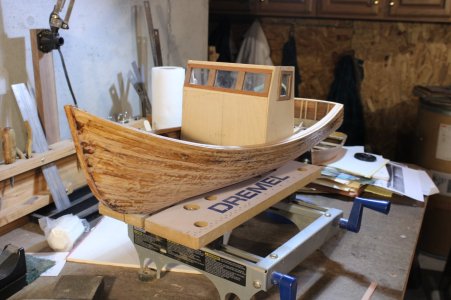

Attached are two photos of my latest work on the Donald David; the cabin. I cut pieces of plate glass for the windows and there are there are three simple replicas of instruments on the dash board: a two way radio, a compass and a special instrument that displays the ocean floor and its rocks; very handy when ever he set traps in a shallow area.

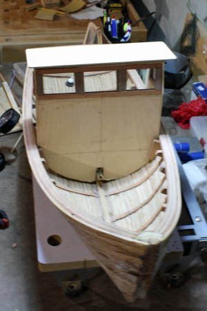

7 replaced
I finally put the roof on the cabin and I added some thin strips to fill the gap between cabin and the walkways. i have started routing wire for each of the five lights in the boat; four of the lights are mandatory on real boats: 1 white lite for stern, 1 red for portside forward hull and 1 green light for starboard side of forward hull and 1 White light on the cabin roof. There will be a white light on the inside of the cabin ceiling, only because that is what Bill West had on the Donald David, it is not "required" on lobster boats. I will be fastening the cabin in place soon.
