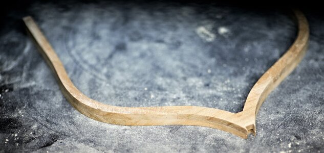

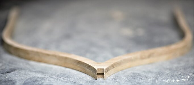

One more thing I'd like to touch upon is double-frames. They do assemble the same ways as a single in the MDF jig. The difference, however, how you glue them on the rising wood as the final destination. So...what are those double-frames? Every second, or third frame - is a double-frame. It consists of two single frames joined together using bolts as the fastening. At first, I thought to imitate bolting on my Alert, I even made some test. But in the end, opted out an left as is 'bare naked' ;)
Here is the test frame.
Two single frames joined together will make a double-frame. But wait, DO NOT glue them all in advance! Here are the steps I outlined and follow while working on double-frames. Later, I will refer to double-frame as the set, with frame 'a' and frame 'b'
