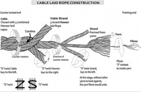

For Q1, I think you are asking the difference between cable laid and hawser laid rope. Cable laid is rope made with usually 3 hawser ropes. And hawser ropes is rope usually made with 3 strands.
For Q2: Z twist and right twist are the same thing. Similarly s twist or left twist are the same.
Does this diagram help:

Well, if you made a cable laid rope from 3 hawser ropes, which are Z twist, then the cable laid rope would be S twist.
I think some claim that the S twist is stiffer than the Z twist, but honestly, I cannot confirm or deny that.
I think mostly all the rope used in the Constitution is hawser rope so Z twist
So Z twist cable laid rope may not be useful for the constitution.

So back to my dilemma which i probably will not work on. How do I make hawser z twist rope from ztwist strands? If I make an intermediate S twist step, then I no longer have hawser ropes. I have Z twist cable laid! lol
