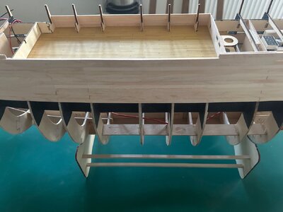

With the deck trimmed and faired, I have started to fit the ceiling planking between the bulkheads using some 5mm X 1.5mm Birch I have spare from the Soleil Royal.
The instructions have you fitting this later after adding some ply supports for the deck edges. I will not be fitting these supports as they are not needed as my upper deck will have a ply sub base and they do make this area look untidy.

Thanks Mike, the planking will be covered inside and outside, it is merely to build the thickness up. The kit has you leaving a void here.

Firstly, Happy New Year everyone. I have not been online much over the holidays as I have been focusing on family time but with some building in the stolen hours.
I have been following the instructions, well almostROTF I will list my departure from the kit build so far rather than cover what is the instructions;
Keel drilled to take M4 steel rod that will be used to secure the model to the stand but also provide +ve and -ve for the 12v supply for the lighting
Kit battery tray repurposed to take digital voltage regulator to provide 2.9volt output for the LEDs eliminating resistors- as I side note, I fried two of the flickering LEDs from the light kit soldering the wires on despite using my smaller iron. You MUST use a heatsink between where you are soldering and the LED body. These LEDs contain tiny microchips and they do not like heat.Lesson learned, I will order another kit from AL in Spain, I plan on adding a few extra anyway.
More supports added to the deck beams fore and aft for the next level.
The upper "Bulwarks are being lined with 0.8mm ply from my stash, these will provide a backing for further dummy frame extensions, I do NOT plan on planking these areas but having exposed framing. No plans exist for the ship post refit, I reason as these areas are extensions of the original hull, there is some argument that these were not planked internally. Looking at Artesania's CAD model on You Tube, it is my interpretation that is what they had in mind when designing the kit then took a u-turn deciding to cover these areas with planking inside. If anything, this will add a talking point to the model and differ it from the masses.
Some pictures of where I am up to.I am working on the planking on the Portside at the moment from the waterline up, then I will revert to the Starboard side. I can get away with not working equally on each side now, the skeleton is so rigid it could withstand a bomb blast.No concerns of pulling it out of shape.
One tip for anyone building this model, I made a shaped former to bend the planks. Soaked them in water for two hours and then clamp in the former.Leave overnight to dry out and they keep their shape when released.My former can take four planks at a time speeding the process up slightly.Every build I have seen so far of this kit, including the one in the instructions exhibits some faceting in the transition of radiuses at the bow, ensuring the planks are accurately preshaped seems to have stopped this so far on my model.
