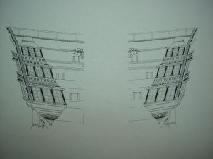

SECTION 1 - Layout
One of the biggest problems I have had with the layout, is the placement of the windows. The metal plate from the kit is pretty beat up. So laying it on the stern back plate and tracing the windows is a hugh waste of time. It would be very labor intensive to correct all the errors.
I took the drawing and reduced it to the 1:90 scale and printed it out. Then I cut it out to use as a template. The cutout will be glued to the back plate using Titebond. One point I need to make, I will have to make a new back plate. As you can see the rendition has a slightly different shape to it... just enough to warrant a new back plate. Once the windows are cut out, I can soak it in water to remove the balance of the template. As you can see, this will leave a very clean window arrangement.
This is all I have for now. I will come back with the results of the window cutting.
