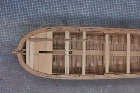

I neglected all of my chores and responsibilities (even a near-obligation) today and sat at my worktable without a care in the world. My morning started with the placement of boards at the bow (no, I didn't mess up - it's actually like this on the real boat):
Next, I added some guides for the oars in the caprail:
And then did some detailing. Here you can see simulated nails on the interior:
And the exterior:
The clinker planking was actually nailed (clinched?) along the entire lower edge of each board but I'm not sure if I want to do that. Or maybe I do. While the pinholes appear quite evident on this picture you can hardly see them in real life under normal lighting...
Finally, my first attempt at an oar. SO FRAGILE!
I'm going to make more oars but not the full complement of 14-16.
I can't get past the feeling that I'm off on the scale of this boat. An esping is normally as long as the beam of the ship it supports, or 1/4 the length of the total ship. As reported in this build report, Dr. Hocker says the Vasa esping is precisely 1/4 the length of the ship and very close to the beam.
The museum reports the raised esping is 11.7 m. At scale (1:64) that means my boat should be around 183 mm and that's what she is.
But the detailing just seems too big compared to the detailing on the mother ship. Hmm...

You keep building things like this and they'll offer you a job at Vasamuseet, Paul.
She is a big girl isn't she?
In comparison to the chaloup or sloop of the WB.
Be that as it may, Paul, I wish my chaloup could look like your Esping. What you have done here is just a superb rendition of a small boat. The details you are packing into her are astounding!

Thanks everyone. Keep in mind that this support boat was almost certainly pulled alongside/behind the ship. If my research is correct this boat would have rarely been brought on board (too large to do so conveniently) - and there would have been one or two more support boats as well that were smaller (thus easier to get onto/into the ship).
Stephan, I was actually comforted by your 14 cm reported size. I'm at 18 cm and building at 1:64 vs your 1:75. And maybe the Vasa esping was just a larger type of boat?
Jim, your post is just too disturbing to reflect on: THAT'S A TINY BOAT!
Question: do you guys think the oar guides are too tall?

Hi Paul,
As long as your oars fit in and the guides and the guides are just above the circumference of the oars it should be right.
I hope that makes sense
As My signature says 'If it looks right then it probably is'.
My thanks to @Jimsky and @Uwek for the confirmation on the size of the oar guides - I was fully prepared to make them smaller, but with your guidance I'll leave them as is. Much appreciated!
