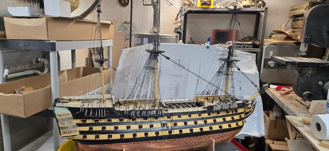

Well, I have finished the ratlines on the starboard side. I had to spend an hour cleaning up my shop that had turned into a dumping ground for all the end results of my summer projects. Bits and pieces of wood, foam, dust. It was a mess, but the upside is that after sweeping I found three deadeyes that I had dropped! Hopefully I can still use them!
All I had were the upper ratlines of the starboard mizzen mast to finish the side, but first I had to watch a video to re-familiarize myself with how to tie ratlines. It came back pretty quickly. Ironically, the upper ratlines are the hardest. These are obviously high up on the boat and even though I tip the model towards me (I put a 2x4 under the port side of the stand), it becomes tiring. The very last 3 have little room to work the lines and tweezers and standing helped.
They're done now, at a glance, not bad. Some dips there and there, but they'll blend in.
Still have a month or so of fall work around the house until I can spend quality time on the model!

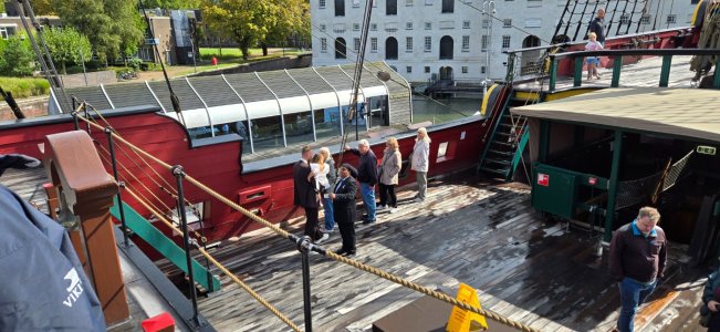

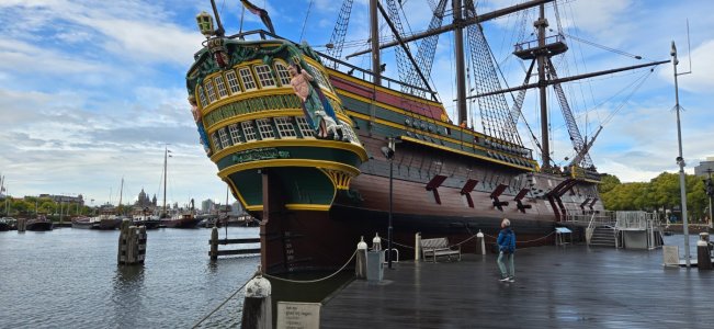

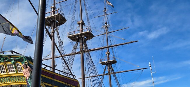

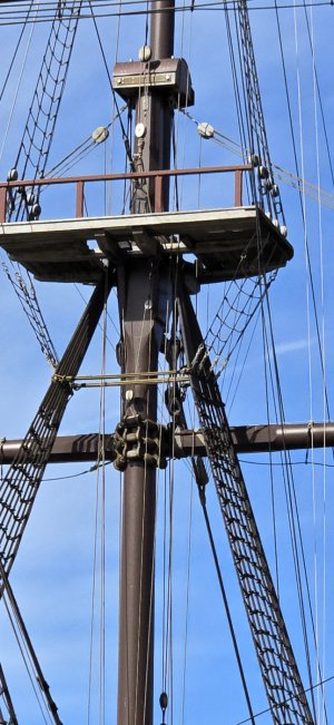

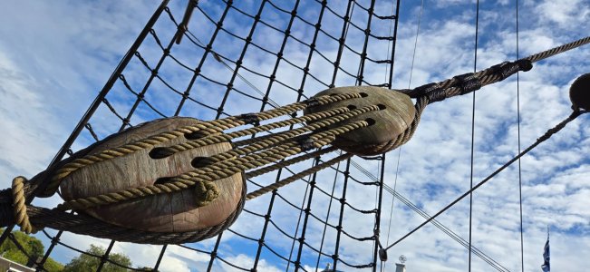

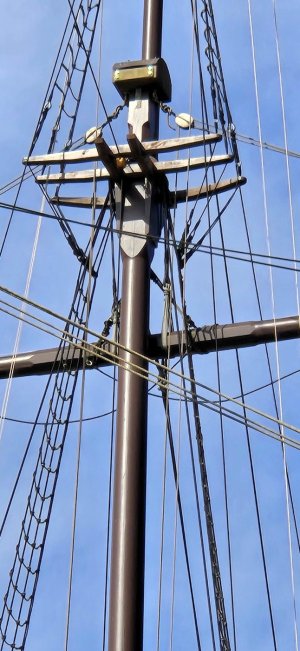

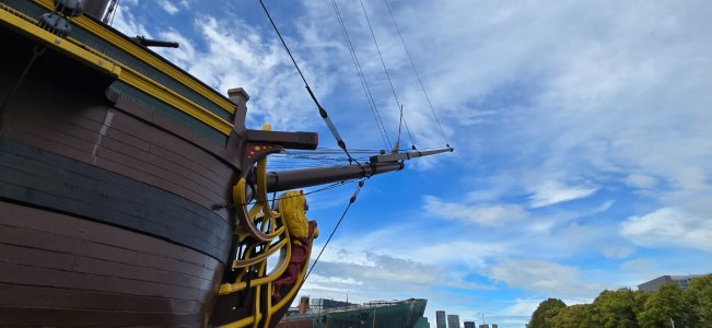

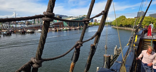

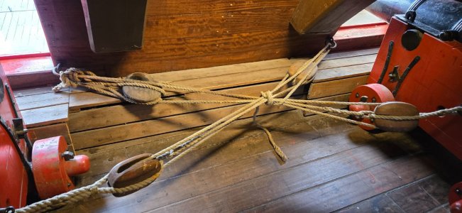

This fall we did a great river cruise on the Rhine River. We ended the trip in Amsterdam and while doing a canal sightseeing trip, I saw a tall ship in the distance. Looking it up, I saw that it was the VOC Amsterdam. A replica of an West India cargo ship from the 1750's.
I loved looking at many of the various apsects of the ship and smiling to myself as I thought...yeah, I built that too!!!!
Loved to see the worming and serving up close, if only my attempts were that good!!!!
Some wide shots of the lower platforms.
Loved the real image of the hearts used to attach one of the stays!

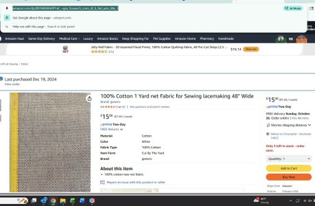

Chris, where did you find your hammock netting? I've looked everywhere.
I found it on Amazon at https://www.amazon.com/dp/B01M060A0P?ref_=ppx_hzsearch_conn_dt_b_fed_asin_title_1
I had bought 2 other types on Amazon, they were rolls of 6" tulle. One was ivory and the other was apricot. They were ok, but very difficult to work with.
The fabric I finally found was cotton instead of a poly and was nice. You do have to be very careful when cutting it, otherwise you'll cut into the next row and it becomes harder to sew onto the rails. Overall, I liked the look and color and if you want, you can stain it with tea or some other dye and it will get darker.
I did that to test but opted to just use the color it came with.
EDIT: I was looking at your build and I see that you are at about the same point as me. Well, you're a bit further along, as you've done the cannon lids and I see you've begun adding the yards. So, no, you're WAY ahead of me!!!!

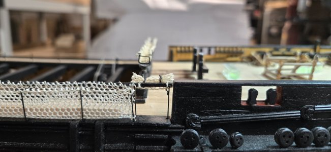

Thanks Chris. I like the look of your netting so I'll give this a try. Did you wrap both sides and base as well or just the sides?
The netting covers the sides and base. I placed a larger piece into the hammock racks and used dowels or stir sticks to keep the bottom of the netting in place as I sewed each side. Once I had a side done, I was able to cut the extra away and then do the other side.
If I recall, I did the inside netting first and allowed the outer side to hang over. I used clothespins to add weight and keep the netting tight.
