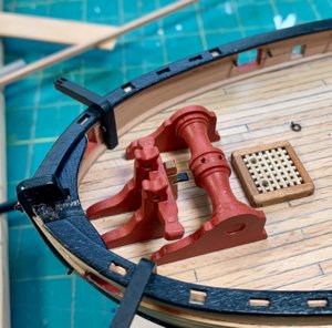

I replaced the last of the kit walnut by building the bits from cherry, the kit provided piece is laying on the hatch for comparison

The kit design and parts has a significant flaw that I recognized and had been struggling to find a solution. The bowsprit bit is either out of scale or just too high. I built the bowsprit, and found two problems. Once braced on the bit It sits to high above the rail, almost 5mm. There is also not way in the plans on how to secure it. I contacted Chris Watten, who designed it over 18 years ago he says and he agreed but didn’t have a suggestion. I’m not sure how the box photo is holding the bowsprit either. He told me on his new Vanguard Alert model, a similar cutter, the stem is much higher and he provides a photo etched brass ring to secure it on the stem at the rail. I tried fabricating one from wire, but that pushes the bowsprit off center and with the short stem it simply wasn’t a solution. So where to go. I could just glue it to the side of the stem but it looked bad sitting so much above the notch in the rail and that’s no way to build a model.
So I ripped the kit provide bit off the deck, got out my trusty tools along with some cherry and boxwood and scratch built new bits.
I was tempted to leave them natural, but it has the reverse affect of highlighting the somewhat oversized wench - I thought about rebuilding that but decided enough is enough, I have Speedy and Cheerful waiting for me.
Seeing the two sitting side by side it doesn’t seem I made much difference, but its far more to scale and the with the difference in height of the bar allows the bowsprit to lay right in the groove with enough clearance on the stem for the later rigging. (the drill is just holding it in place during this dry fit, the blue tape on the connecting dowel is so I don’t loose it on my work desk)
I’ve now completed all the deck furniture, next of is the rail stanchions and gun mounts, plus two cannon left to paint. Off I go.
