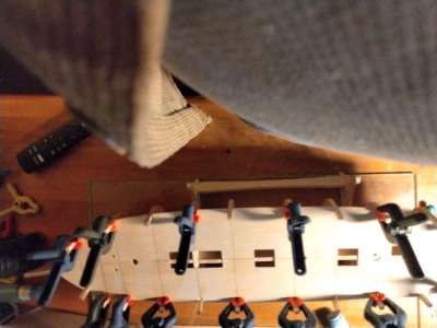

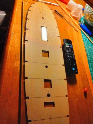

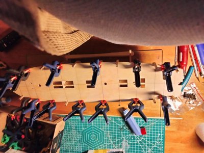

I'm waiting for the false deck glue to cure before sanding the edges and sanding the bulkheads.

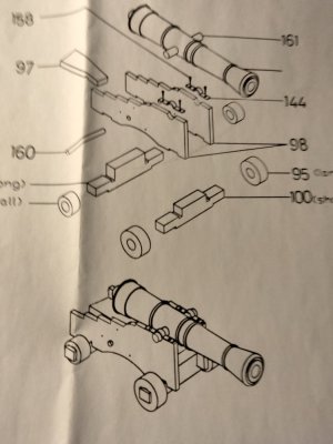

Looking ahead I don't know how to make the gun carriages.
The plan shows the axles as square as are the finished openings in the wheels
The wheels provided have a hole in the center.
Should I try to round off the axle ends.
I can't even conceive how I would go about cutting a square hole in these small fragile wheels.
PLEASE PLEASE do not cut square holes in the trucks. :) There have been a number of posts here at SoS about an easy way to round the axles with a home made axle cutter. The drawing with a square axle is pure fantasy. You might take a look at post #36 at this link: https://shipsofscale.com/sosforums/...d-48-1695-1-64-scale.15460/page-2#post-420156

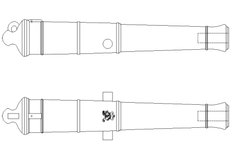

You can make these using appropriate sized tubing so no need for a lathe or such. There was a great thread by Jimsky https://shipsofscale.com/sosforums/threads/aftermarket-naval-guns-parts-to-upscale-part-2-3.13209/ as well on making an axle cutter from tubing with hand tools. The OD of the rounded part of the axle is about the same dimension as the thickness of the carriage brackets Looking at the drawing from the kit that you posted the cannon looks more like a Borgard pattern gun (1716-1724) than a Blomefield which would be appropriate for Jalouse. The Blomefields (circa 1790-1835) had no chase astragal on the barrel. See pic of a Blomefield below: 1737077160502.png
If you are happy with the kit guns, go for it. If you would rather something like the pic, I would be happy to send you STL drawings to have them 3D printed with the ring and cypher included.

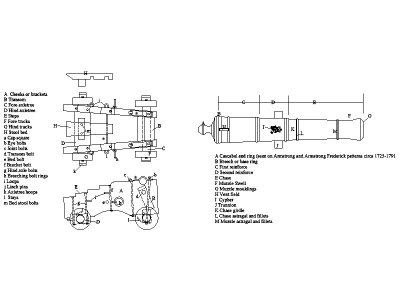

Sorry if some of the terms are not clear. The following drawing of an Armstrong pattern gun and carriage explains better than words. This is the wrong pattern for Jalouse but I hope you find the names of the parts helpful.
I hope you find the above useful or at least interesting.
Hey Ted, don't overthink this ship modeling project. You know that wheels don't turn on square axles so don't fall for lousy instructions! If you can complete the plank-on-frame Bluenose you are going to conquer this current project! You've got this!

Thanks, I figured it out. I'm just rounding off the axels. I'll include a photo as soon as I finish the initial sanding.
