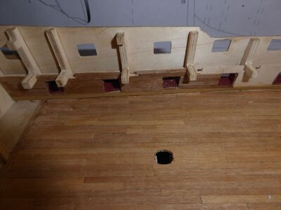

Upper gun deck now completed
The process was quite simple and straight fwd.
The inner gun port templates have a notch at the top with sufficient leeway to move left and right to allow inner side alignment with the outer gun port template.
To make this easy when gluing, I found that the leftover ply from the ship support cradle had three long sections that were the exact width of the gun ports. I cut these out and this allwed me to align the ports vertically for gluing
The templates were then glued into postion and clamped for drying

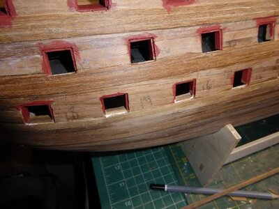

When dry I measured the lower lip of the internal gun port template and although correct at the bown and stern was correct however the middle ports were up to 2mm higher on the center ports. I made up one gun carriage and placed and it was correct on the ends bit as expected wrong in the centre.
It was simple to cut these down to match the external port edges with a excacto.
These were then lined and re checked with the cannons to be correct.
The ports were then painted with Jotika Admiratly paint Red Occur ( Jotika Victory Paint set)

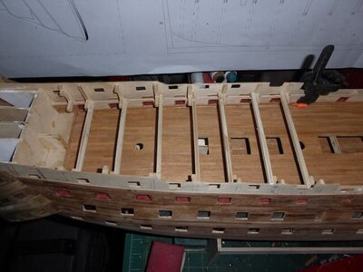

The 2nd planking was then continued up to the upper deck level and again stopped.
Next the centre line of the deck was drawn in and a single full length plank placed and glued and allowd to dry
The rest of the planks ( a LOT!!) were cut to 85mm as per the mnaual to allow a 4 but shift ( done either side of the central planl
The deck was then completed, sanded and a coat of matt sanding sealer was added ( Still wet hence the gloss)
The internal gunport planking is next, then its flip over and the whales....
Till next time......

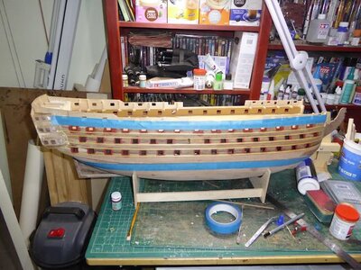

Paint lines & water lines added by painters & tamia masking tape.
Now to a bit of relaxing paining before its COPPER time!

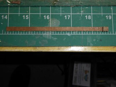

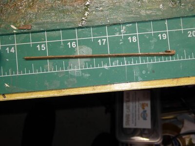

Adding the whales ( Position measured directly off plan. Upper two whales are 1 x 3.5mm x 3 each, lower is one 1 x 4x.5mm & the other 4 1 x 4mm std planking. These were also contact adhesive laid. Once on laid they are hard to see at a distance. ( the light lank is not missing its juts that colour on hull
The Actual plans ( not the Kit ones or suggested method) have the whales consisting of Anchor cut stock laid end and butted up. I had considered this, but at the size & thickness ( 1mm) and when painted and sanded it becomes invisible at this size. After due consideration the effort for me and my eyesight it would not have justified the final result ( at 1.48 yep but at 1:72 no)

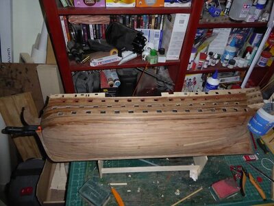

The gun ports were fairly easy in the end. I did the vertcle sides first ( the middle gun port level was easy as one side of the ports lined up with the internal bulkheads so was easy to fix in place.) I used PVA contrary to suggested CA(Quick hold but fragile). Using the special applicator, the amount of glue and the lightness of the cut piece held in place till the PVA dried.
Once the glue had dried for one side the other was added. The bottoms where then simply then pressed into position and held byt the sides and slight over length pressure. Once these were dry, it was flip the hull and repeat for the port tops. I was lucky and only dropped 4 into the hull ( 2 shook back out, so I still have 2 rattlers!. In the end it was a fun process with very little vocalization!
