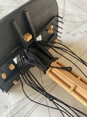

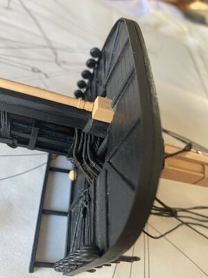

Cut off my Mizzen futtock shrouds the other day and removed the stave - nearly created a disaster as I clearly applied too much CA mainly due to 3 different knots from different ropes coming onto the stave at the same point. When taking off this mess I snicked the fore port shroud.... as per arrow. I applied a little CA glue to the damage and I am hoping that this will not unwind. My shrouds became fuzzy again were they where manipulated. A little “fire” will sort that out;)

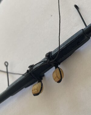

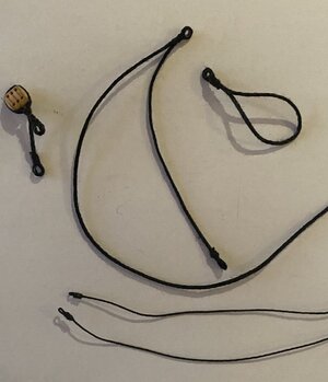

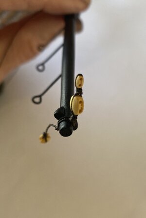

I started rigging the Mizzen cross Jack-
The 1st photo below shows:
1. The jeer blocks. These are lashed to yard 2nd photo down.
2. Sling (I was going to seize this however the space going through the crows nest I made 1 mm and too small for siezed sling) - happens when bashing kit and being pretty clueless at same time.
3. The lines for the “down haul “ (term to be found). These will be looped through each other then around the aft of the mast and down through block and tackle to base of mast. 3rd photo down.
Next :

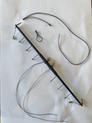

The topping lift block (5mm)and topmast sheet block (5mm) are joined together- interesting to make. The brace block pendants which hang off the yard are also attached (5mm).
WIP to date on the yard : Cheers Grant

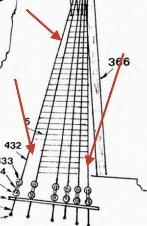

Good morning.....and Grants learning curve goes vertical. I am glad I made the call to practice and build the Mizzen as a practice as I am making many errors. Ratlines: Not only did I get the gap between the fades wrong, I also got the pattern wrong by “rattling“ across all shrouds. HMS Victory has an irregular pattern see below with arrows.
As with my Futtock shrouds I cut off my Ratlines and am starting to redo properly. Took a while to take these off.
I did start the top shrouds with the correct gap 0.4mm for my Victory. Is correct and looks way better as well. Cheers Grant

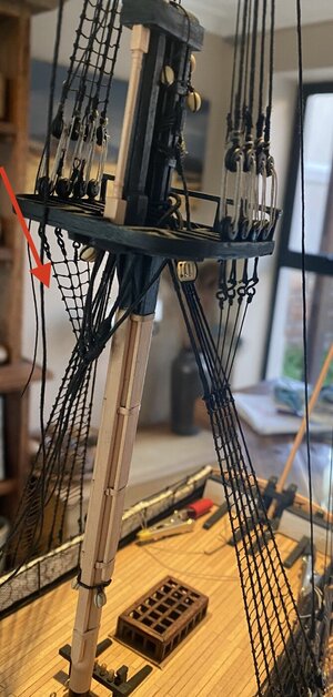

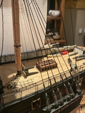

Good morning. While adding blocks to the masts I have made some progress to my Mizzen standing rigging.

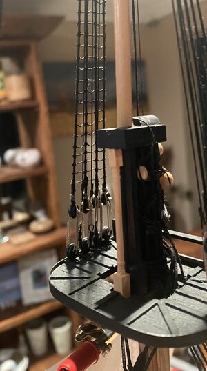

Good evening. Futtock shrouds redoing and ratlines. Some problems- I am having to dye all my rope. Use Indian ink and it is good except for ratlines as the learning experience has shown me. It makes the thread “not smooth” so the clove hitches don’t pull and tighten easily. I will need to change the dye process here.
The good thing is that it gives a really realistic tar effect.

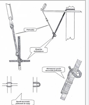

For the futtock shrouds redo I went for the alternate method (not realistic) as to try (for my skill level) the authentic approach, there was too much thread looped around the stave and it looked “blobby”. In addition the car thins still need to be added. Reason why I redid these. I did not like it...less is more. I also “ cheated” and only did one whipping using double half hitches. Just too much thread in small area otherwise.

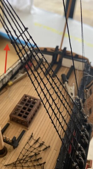

Progress on the ratlines. Everything I did not want, happened.....got to love this hobby CautiousSicko_O:oops:. The arrow shows some lines I need to straighten. I only used a drop(still too much) on the start on Finnish so I can align those which are out.

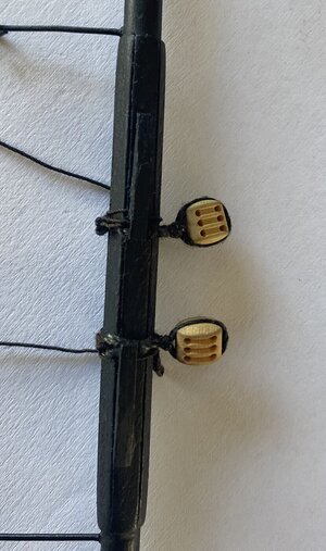

In this close up the method of fixing the futtock is shown.
The red arrows show what you don’t see with the normal eye- shroud came out of alignment (I can easily slide this across, and the stave cut off are irregular. Needle file should sort this. Blue arrow shows the old block which still needs to be replaced(what a difference good blocks make).
