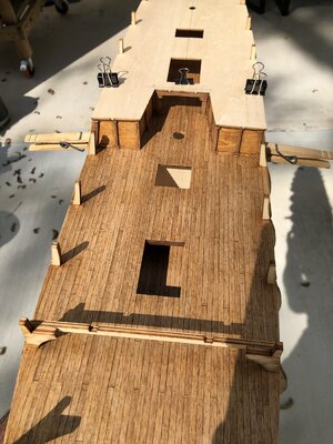

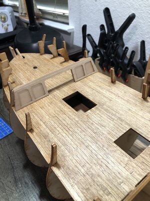

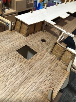

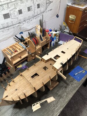

After looking at the deck, I knew I wasn’t done. So I added stain, and then when dry, used steel wool. The nice thing about this process is that I put clear on first to prevent the stain from penetrating too deep in the wood. That way the stain stays in the wood grain and nail holes, but gets mostly removed on top with the steel wool, to lighten the color. This also gives it a nice natural worn look.
I also painted black around the unplanked areas at the stern. That way if by chance you can get at the right angle to view past the planked area, then it will just look like a shadow verse being unplanked. ;)
And finally, the nails are subtle, because I want them visible at close distance, but not so much from far away. Just like a real ship.

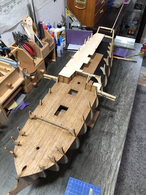

Next I will make this wall towards the bow…

Looking good. Just a tad more grayish and slightly darker would be my choice, but still, you're the man in charge, so you decide. ;)
Problem is… too get more grey, you have to remove more stain. The more stain you remove, the lighter it gets…lol. So darker and more grey is not really an option. Other thing is a photo rarely represents the actual color seen in person. It looks really good in person. Also pics are taken in bright light. I need to take an outdoor natural light picture. Then I will post. ;)
Ps - a final note, surrounding walls factor into shade. On the BN deck, I was worried it might be too dark. But with white bulwarks it was perfect. In this case if it looks a little light, with the dark walls, it will most likely be ok.
I like the brownish tones of the deck the way you have it. There is enough variation in color to make it look lightly used without appearing beat up and greyed out by the sun and salt... Once you go in the direction of aged you have to go all in - and that has never been the 'theme' of your work thus far. But as our colleague rightly offered: you're the captain!
Thank you for your input Paul! That is the look I was after. I am leaving it alone at this point. Besides, whatever recipe I use as far as steps go, I have to be able to duplicate on two more levels of decks! ;)

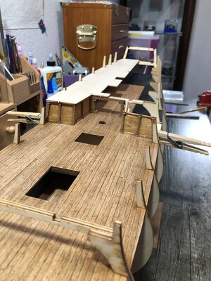

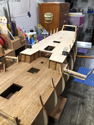

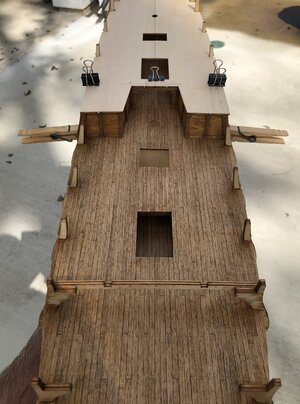

I took a few pictures outside to show how lighting effects the color.
In the shade verses sun…0AD2977D-AE7E-41E1-A14C-CA1B0BDDD395.jpeg1C67381B-F793-46BF-871C-80F093371D09.jpeg
The weathered deck, the fade out of the nails, both really well done Dean. At first I thought there might be a disconnect between the deck and the wall panels as they pertain to weathering but now I see a beautiful harmony especially in natural light. I say well done so far.
In the shade verses sun…View attachment 264128View attachment 264127
That's one real good looking deck!
I also appreciate the "floor nails", very subtle, yet there.
