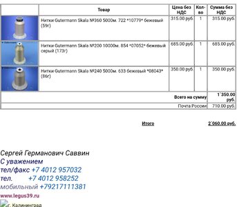

In the begining of my rigging ,I made it very roughly,used too thick strands...but later on, I have found Gutterman Scala... it is like mono strand...very thin and handy to use for this purpose...
It must be painted before use as well...it keeps knonts tight and prevents undone...in process better use some" 3rd hand", for convinience ...
This is Scala details...with Nos

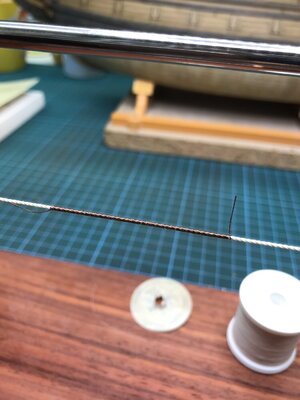

I am now trying to create served rope…

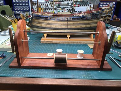

I made a small jig for this purpose, and it works fairly well, but as far as I can understand serving a rope consisted of 3 steps:
1-Worming
2-Parceling
3-Serving
I omitted the first two and did only the serving, the problem is that the rope does not look cylindrical… you can still see twisted strands!!
I don’t think it is practical to do the worming, but I would like to know what you think, does anybody do the worming before the serving? Or it is just me going nuts…?

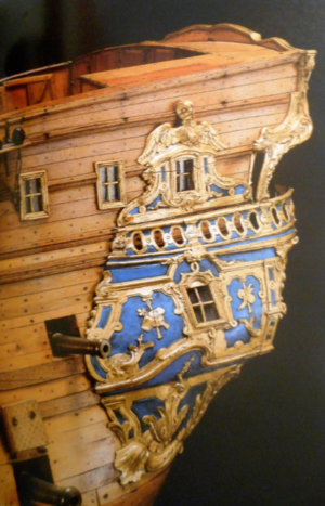

If I were to do it over - spoiler alert: I won’t - I would definitely do what you did with the lighter blue and the darker oil. You have managed to capture this effect, which I like so much:
As you might well imagine, I could not agree with you more. For all of its problems, Heller does manage to get quite a number of things right. The kit is, after all, a very close copy of the Tanneron model.
Contrast that with the brand new Artesania Latina SR:
There is no comparison. At least with the Heller kit, you have a jumping off point from which you can make something really good. I do think you can make a better version from this new AL kit, but it would be a significant effort at reverse engineering.
That model from Augustin Pic is one of my all time favourites, you sure get it where I got inspiration for the blue… spot on!!
