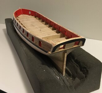

The painted bulwarks certainly change the look of the model. Now I’m looking ahead to coppering the hull. Firstly, a stamping jig had to be made as described in the kit supplied manual.
Once the jig is made the stamping process is simple. Hit it with a hammer ;). Ok, tap it, but consistently, to get a repeatable embossed nail pattern. Experimenting is taking lots of time and lots of tape.
