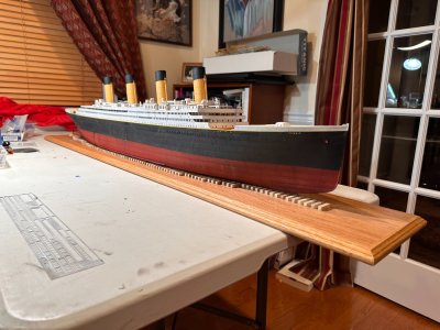

For my display base, I was inspired by Peter Davies-Garner’s book, “RMS Titanic: A Model Maker’s Manual”. In it, he states:
I chose an oak plank which I cut to 5’ (153cm) in length and added molding on all sides. I finished it with tung oil.
View attachment 617021View attachment 617018
I used a track saw to cut the oak board to length. A regular circular saw would’ve been fine, but I wanted to make sure that my corners were perfectly square so that my trim miters would look clean.
View attachment 617020View attachment 617017View attachment 617023
Lot’s of sanding: 60g/120g/220g/320g to make it smoooth. I like Osmo Polyx-Oil for projects like this. It wipes on with a cloth and preserves the feel of the oak.
View attachment 617022View attachment 617014
I taped several blank sheets of paper together to trace the shape of the hull, which I reduced to groups of strip lengths. Using the template, I marked out the locations for each strip length on the oak board. The strips (“blocks”) were made from 1/4” (7cm) poplar and cut to length using a small miter saw. Each was glued to the base using Gorilla wood glue and spaced using a scrap strip as a spacer.
Eventually, after much cutting and gluing, you get something like this.

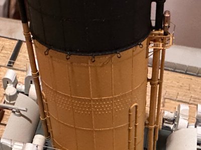

With the 3D printed funnels, are you going to drill in holes from the stays?
The drydock method looks great on your Titanic. Its the same plan I will use on my 1:350 Titanic when I get to that point. I haven't thought about the layout yet, but your method looks great and I will probably use it when I get there. Thank you for the inspiration on you build
