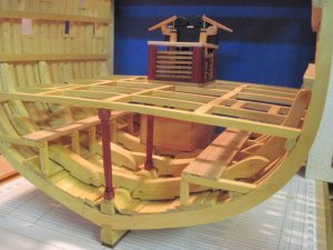

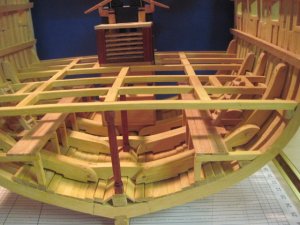

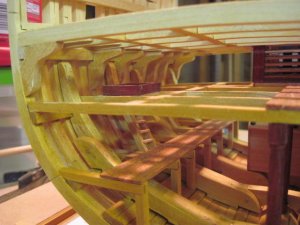

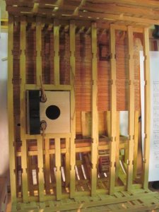

Orlop Deck Framing:

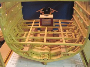

The orlop deck framing above the hold platforms and the position of the well room is shown on the following photos.

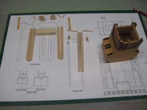

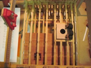

Pumps:

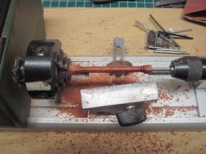

The model has both chain and hand pumps. The construction and installation of the pumps is shown in the following photos.
IMG_3434.jpgIMG_3435.jpgIMG_3443.jpgIMG_3444.jpgIMG_3445.jpgIMG_3446.jpgIMG_3447.jpgIMG_3448.jpgIMG_3449.jpgIMG_3450.jpgIMG_3451.jpgIMG_3452.jpgIMG_3453.jpgIMG_3454.jpgIMG_3455.jpg

Hi Mike,
As always beautiful work and such great detail. I especially liked your wood lathe work. :handgestures-thumbup:
Thanks Mike,I have a Proxxon lathe that works great for modeling. I have had it for five years and no problems so far.
Mike
Thanks Brian, I am glad you like the build.
Mike

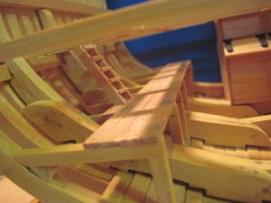

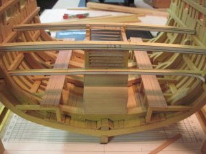

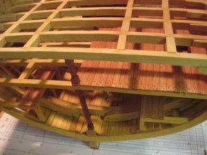

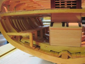

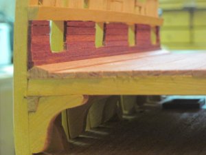

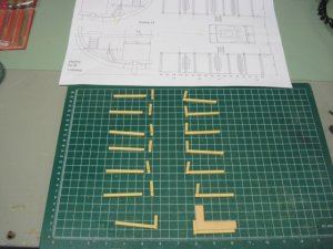

Hold Platforms:
There are two long platforms just above the floor with the supports attached to the sides of the hull. This set of photos shows the platforms and supports.

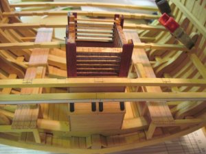

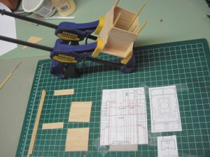

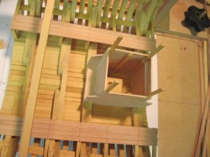

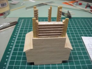

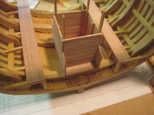

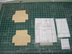

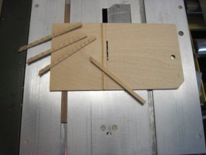

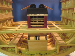

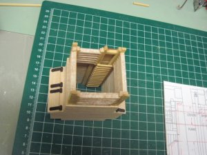

Well Room & Shot Locker:
The well room is a nice little project by itself, the first set of photos show the lower part of the room is a solid wall construction and the second set shows the louvered walls.
IMG_3391.jpgIMG_3392.jpgIMG_3393.jpgIMG_3394.jpgIMG_3395.jpgIMG_3396.jpgIMG_3397.jpgIMG_3398.jpgIMG_3399.jpgIMG_3400.jpgIMG_3401.jpgIMG_3402.jpgIMG_3403.jpgIMG_3404.jpgIMG_3405.jpg

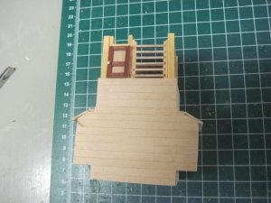

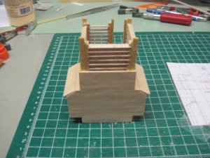

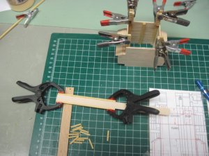

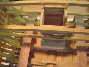

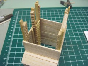

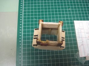

Well Room & Shot Locker (continuation):
The construction of the louver walls, internal ladder and shot locker is shown in this set of photos.
IMG_3408.jpgIMG_3409.jpgIMG_3410.jpgIMG_3411.jpgIMG_3412.jpgIMG_3413.jpgIMG_3414.jpgIMG_3415.jpgIMG_3416.jpgIMG_3417.jpgIMG_3418.jpgIMG_3420.jpgIMG_3419.jpgIMG_3421.jpgIMG_3422.jpg

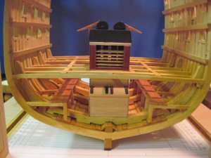

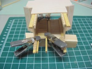

Well Room & Shot Locker (continuation 2):
Finishing touches of the shot locker and installation of the well assembly in the model is shown on the following photos.

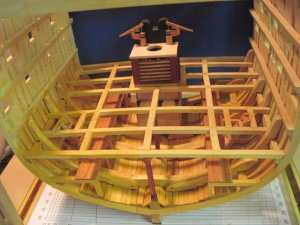

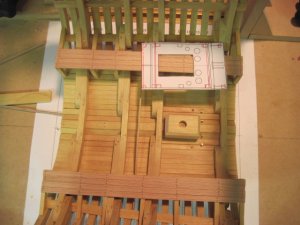

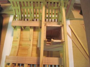

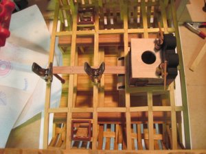

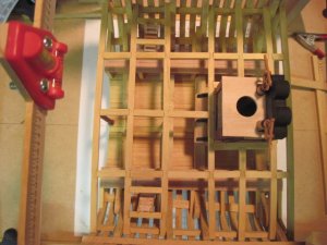

Lower Deck Framing:
The lower deck framing around the well room and support columns are shown in the following photos.
IMG_3461.jpgIMG_3462.jpgIMG_3463.jpgIMG_3464.jpgIMG_3466.jpgIMG_3467.jpgIMG_3468.jpgIMG_3470.jpg

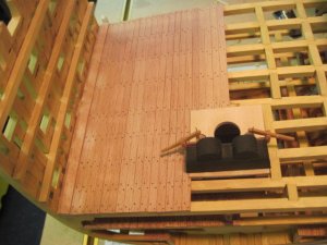

Lower Deck Planking:
This is a few progress photos of the lower deck planking.
