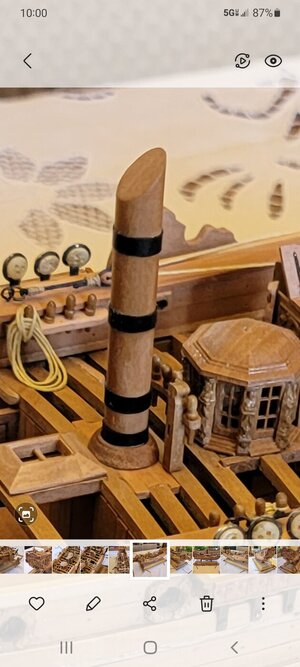

650pcs Heat Shrink Tubing Black innhom Heat Shrink Tube Wire Shrink Wrap UL Approved Ratio 2:1 Electrical Cable Wire Kit Set Long Lasting Insulation Protection, Safe and Easy, Eco-Friendly Material https://www.amazon.com/dp/B07WWWPR2X/ref=cm_sw_r_apan_glt_i_TKR73FPNFRH058DQ5GCT
Used on my last built, Pegasus, on masts and anchors.
View attachment 289975View attachment 289976
Cheers
Daniel
I like that concept, Daniel. However, I am a bit skeptical about using it. What may happen overtime when it will dry out? It will be loosened or cracked? That would be interesting to know...
That could be and is a good question. For sure, if I see that happening I will post it.
I took the idea here , from SOS. but I can't remember from what thread.
Those "rubber bands", have been covered with the shellac or poly I used. In a certain way are protected from the room weather changes :-) .
And if they have been designed to cover electric wires... hope they survive for a very long time. Nevertheless, no electrician will covers them with poly/varnish/shellac. I used them on my Slot Car hobby, for soldering the motor wires. That's a good way to cover the very small wires used on the car electronic board. Never failed after years. But the idea to use them on ship modeling came from SOS, from a post like mine. :-)

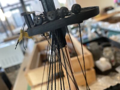

A hearty hello to everyone. Intermittently I have been trying my hand at rigging the dead eyes to the shrouds. I had a go using this methodology:
To align the dead eyes I used hardwood and measured the position of the dead eyes. I used the rigging plan provided to establish the position of the foremost one.
I secured the hardwood to the channel just behind the lower dead eyes already fitted. Using 3 nails through the first, 4th and last dead eyes, rather than wire in above diagram as it is easier to remove the board, it was fitted to the channel.
Making sure the shrouds looping around mast where all correctly positioned I pulled each one down to the lower deadeye on the Chanel and marked the board to reflect the vertical line of each shroud.View attachment 285264
The horizontal line was then draw in parallel to the channel at the height determined from the plan.
As each deadeye has the 3 holes all over the place (No uniformity)I had to place each deadeye individually and drill the holes for Each one with the upper center hole following the vertical line.
I then attached each dead eye with copper wire and placed it back on channel and inserted the nails.
I double checked the sequence and position of the shrouds around the mast and took the shroud line around the deadeye on the board fore to stern and made 3 lashing as per diagram above. I left a small gap on the lower lashing for the lanyard lines to go through to be tied off when I get to these one day. (I’m not sure if these are to big or not, However once done the lanyard line should cover the gaps. I attempted to keep each shroud tension the same (not so easy) and this was Grant guess work.
Once all done I removed the copper wires and nails. I repeated the same for port and starboard.
I have thought to buy new rope as this rope frays and doesn’t give defined detail, however I am too far into the process. If I change now there will not be conformity across my ship. I am happy however it could be better.

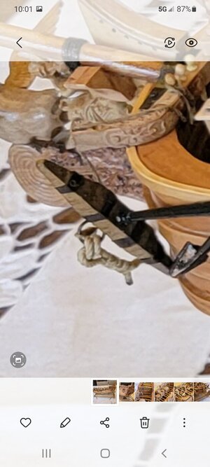

Good morning. Quarter Davits.
The fitment of the hinges for the quarter davits need to be installed prior to the completion of the dead eyes.....in my view. I think it will be difficult to do so once the shrouds are fitted.
Some details I would like to add to the kit instructions. In fact the whole rigging, block attachment, tackle etc need to be changed from the plans. The kit is devoid of such detail.
The real ship in Portsmouth:
I have marked the changes- inserted the shaped ridges along each Davit, drill the four holes for the tackle lines in each, add the blocks and change the rigging and attachment there of for each Davit.

I started this process:
Measured the Davits per instructions for length and scale using 3x3 walnut. I scratched my left over wood and found some 2x1 walnut strips which I glued based the Davit . With an exacto flat blade a blade I cut the leading edge off to get the shape of each. The hinges I soaked in acid for 10min and will apply antioxidant flat black paint(it works for me as I don’t have brass black here in SA).
I made a little stencil with 4 holes which I will use to try and get these drilled in correct place and consistent on each Davit-very little space to work with. I will use a 0.6mm drill bit....

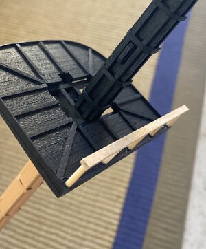

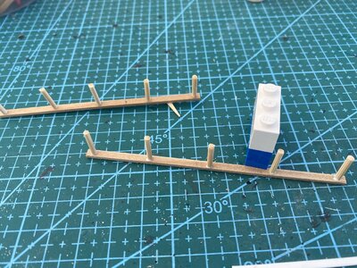

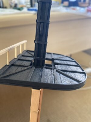

Good afternoon- not often I get to play with my Victory in the afternoon. Progress with the fore and main masts. Made the stanchions for the balustrades from toothpicks cut to 1.2mm and used 3mm x 1.5 walnut for the balustrades. (As previously mentions total change from the kit). Used my trusty LEGO to get the right angle for each stanchion. 2D71F80A-DCF9-48C1-8631-220AF9F365C8.jpeg90E3943F-75C7-43EA-A47B-16C6AF4C46F3.jpeg
Now to paint nice Matt black:D:D:cool:
Good afternoon- not often I get to play with my Victory in the afternoon. Progress with the fore and main masts. Made the stanchions for the balustrades from toothpicks cut to 1.2mm and used 3mm x 1.5 walnut for the balustrades. (As previously mentions total change from the kit). Used my trusty LEGO to get the right angle for each stanchion. View attachment 290157View attachment 290158
I never thought of using my legos for measuring right angles for stanchions! I just used my non-calibrated eyeballs.

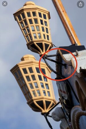

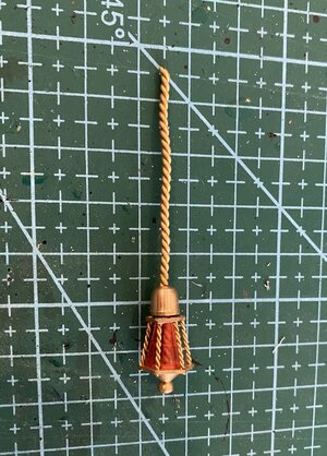

Good morning- I made the main mast lantern this morning as per the instructions. “Eish” I think this and looking at others builds of how metal work completes a model has “forced” me to give this a go.
This is how it is supposed to be. I doubt I could make the lantern however I am going to give the brackets (circled) a go. Worst case revert back to kit )
