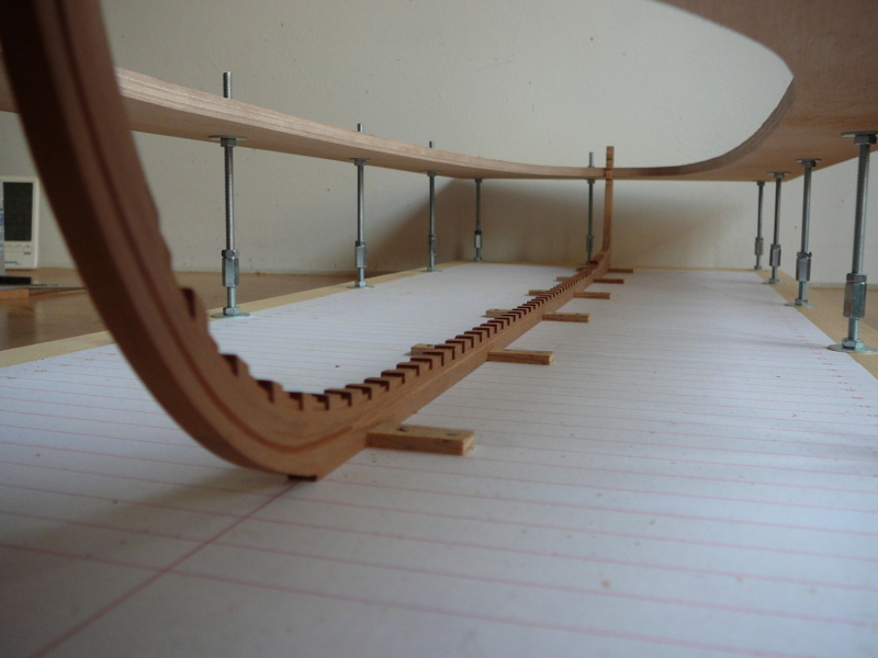

Looks like a La Belle Poule in the photo above, Am I correct?
Sorry Jim it is La Renommee built by Petr Simek in scale 1:48 ;)
